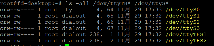

Just writing some notes as I look…
  • β€œttyS0” has address 70006000 (0x70006000").
  • β€œttyTHS1” has address 70006040 (β€œ0x70006040”).
  • There has been no mislabel of the same device (same address) with two different device special serial numbers. Meaning udev did as it should and gave the next UART name β€œtty...1” rather than giving a single piece of hardware names β€œtty...0” and simultaneously something like β€œtty...1”.
  • Some interesting dmesg log lines:
# egrep -i '(ttyTHS1|ttyS0|console)' log_dmesg.txt
[    0.000000] bootconsole [uart8250] enabled
[    0.000000] Kernel command line: tegraid=21.1.2.0.0 ddr_die=4096M@2048M section=512M memtype=0 vpr_resize usb_port_owner_info=0 lane_owner_info=0 emc_max_dvfs=0 touch_id=0@63 video=tegrafb no_console_suspend=1 console=ttyS0,115200n8 debug_uartport=lsport,4 earlyprintk=uart8250-32bit,0x70006000 maxcpus=4 usbcore.old_scheme_first=1 lp0_vec=0x1000@0xff780000 core_edp_mv=1125 core_edp_ma=4000 gpt tegra_fbmem=0x800000@0x92ca9000 is_hdmi_initialised=1  earlycon=uart8250,mmio32,0x70006000  root=/dev/mmcblk0p1 rw rootwait rootfstype=ext4 console=ttyS0,115200n8 console=tty0 fbcon=map:0 net.ifnames=0 quiet root=/dev/mmcblk0p1 rw rootwait rootfstype=ext4 console=ttyS0,115200n8 console=tty0 fbcon=map:0 net.ifnames=0
[    0.001673] Console: colour dummy device 80x25
[    0.001685] console [tty0] enabled
[    0.001691] bootconsole [uart8250] disabled
[    0.393338] console [pstore-1] enabled
[    1.125434] console [ttyS0] disabled
[    1.125506] 70006000.serial: ttyS0 at MMIO 0x70006000 (irq = 63, base_baud = 25500000) is a Tegra
[    1.125609] console [ttyS0] enabled
[    1.126615] 70006040.serial: ttyTHS1 at MMIO 0x70006040 (irq = 64, base_baud = 0) is a TEGRA_UART
[    1.129969] Console: switching to colour frame buffer device 240x67
  • Note that β€œbootconsole” for uart8250 is from the bootloader, and uses the legacy driver (thus, once in Linux, it is β€œ/dev/ttyS0”).
  • The kernel command line does as expected, and names ttyS0 to be the serial console.
Then, for some unknown reason, I see ttyS0 console disabled, followed by enabling it again, but naming is still valid as ttyS0 remains as an alias to address β€œ70006000”. β€œttyTHS1” has not yet been mentioned, so everything is normal to this point.
After the above ttyTHS1 is assigned its name and bound to address 0x70006040, but this is just UART setup and does not yet associate this with serial console. In fact the dmesg log never tells us that ttyTHS1 is ever assigned as a console.
So far as the operating system goes during boot, using its configuration files, there is no error. It is like some other software adds ttyTHS1 to serial console without the operating system itself ever doing this. If there have been no changes by you, then you have found a bug. A possible exception to this though is that if console did actually switch, and it isn’t just a mislabel of the device, then a log line would have been lost during the changeover, and the old device might have stopped logging.

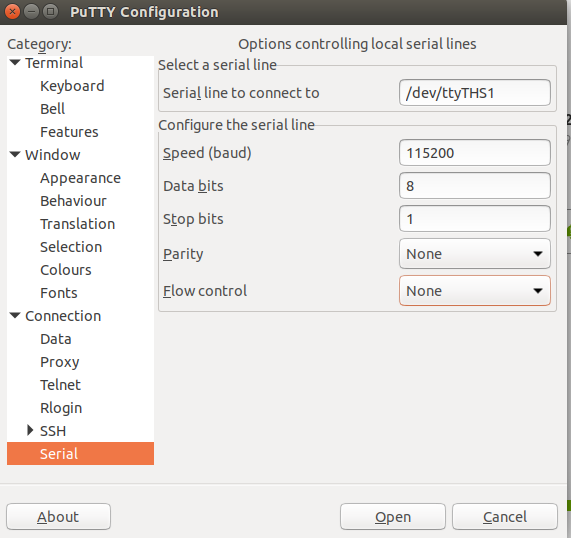

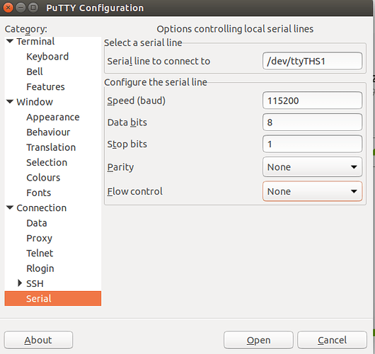

I Can’t open /dev/ttyS0 and /dev/ttyTHS1 with putty as normal user. look at the screen captued below:
This is the error message from terminal
ion@ion-desktop:~$ putty
(putty:9139): Gtk-CRITICAL **: 15:50:30.869: gtk_box_gadget_distribute: assertion 'size >= 0' failed in GtkScrollbar
I can open both /dev/ttyS0 and /dev/ttyTHS1 with putty as root user at the same time from the different terminal. No error message from the Putty
