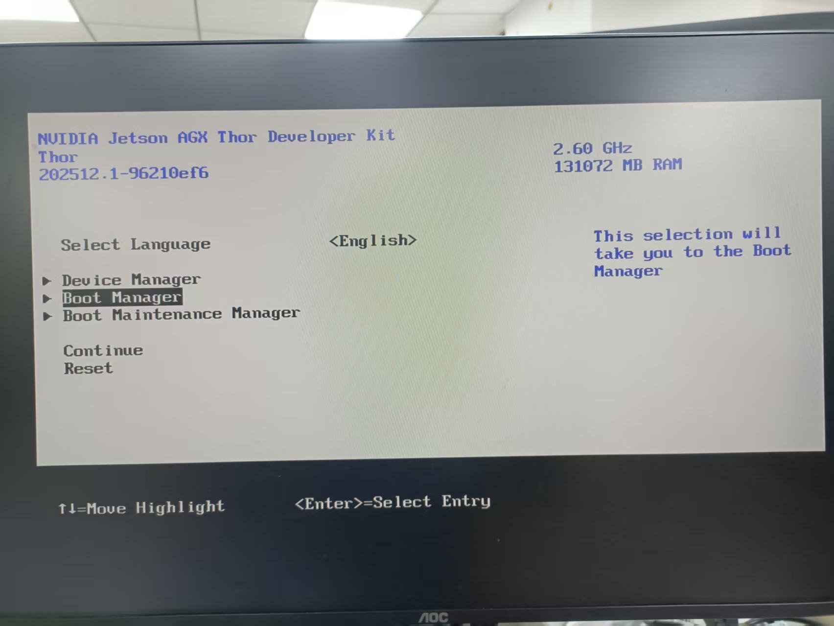

I don’t see the message like Booting Jetson Linux... in the log you shared.
What are the options inside Boot Manager of UEFI menu?
How about the /boot/grub/grub.cfg in your case?
grub.cfg.txt (5.1 KB)
