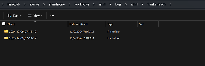

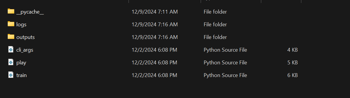

I’m just getting started in lab but hopefully the little I know can help here
in
.IsaacLab\source\standalone\workflows\rsl_rl
Run your training file it will produce the logs folder
inside that you’ll find
.IsaacLab\source\standalone\workflows\rsl_rl\logs\rsl_rl\franka_reach
This has the trained model_50.pt file or however many iterations you did
I had to play about with it to get the correct path but use this style of format for the play.py I had to add the load run with my folder in this case 2024-12-09_07-18-37 then the check point argument then the model.
if you have completed your full run you might not need the --checkpoint argument
python play.py --task Isaac-Reach-Franka-v0 --load_run 2024-12-09_07-18-37 --checkpoint model_50.pt
I got it to run on myside so hopefully this works for you. Let me know!
