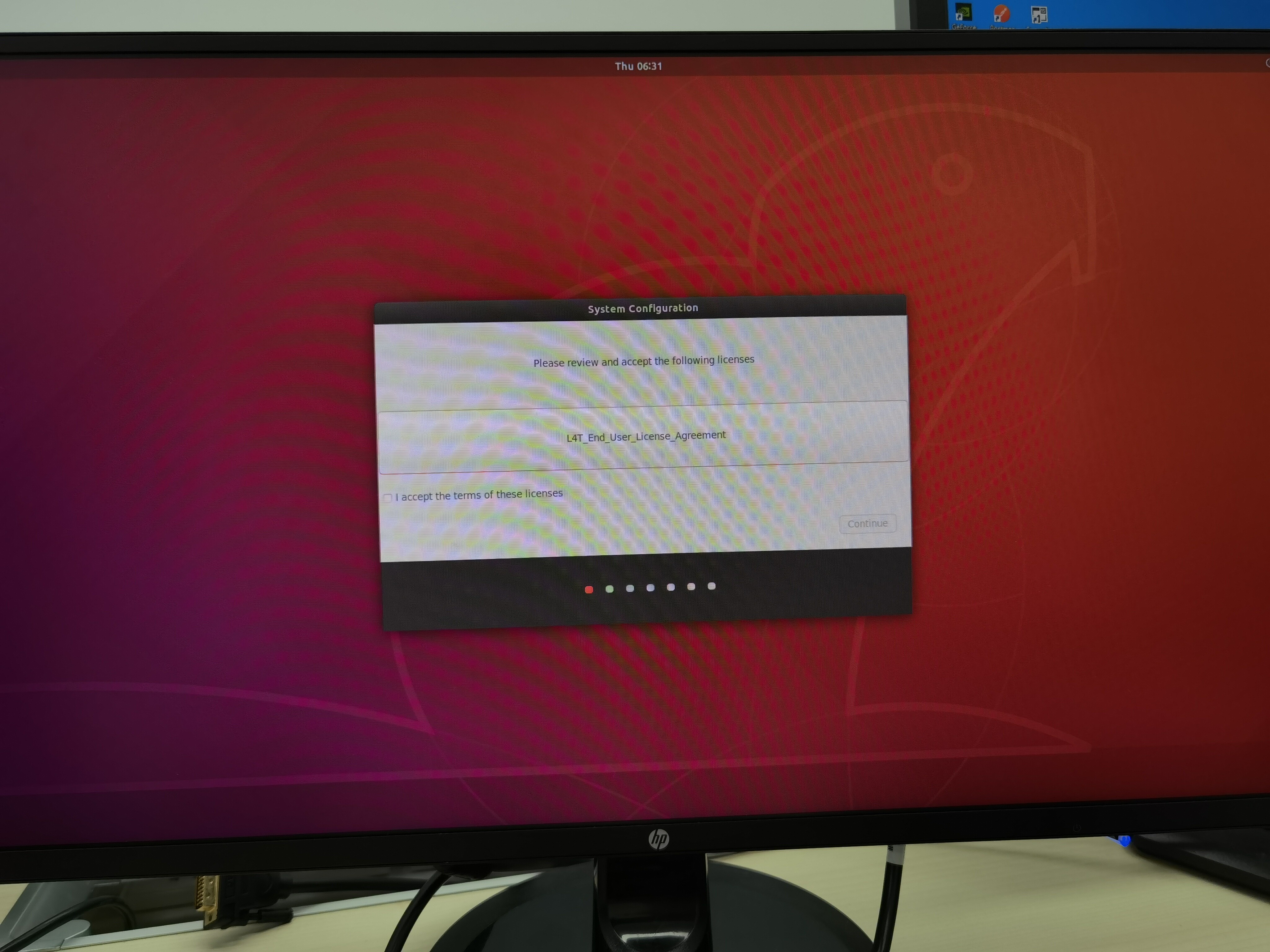

There are also pictures taken during the restart of the TX2.
Why is there such a situation after the Jetpack version is upgraded: only the basic image has been refreshed without the Jetpack version, and the original system image has disappeared.
Please support me, thank you very much!

hello 18916135705,
that’s due to environment setups, please complete that on the target side.
please also check developer guide, Skipping oem-config. you may run the host script before you flash to make the first-time boot process skip it.
for example, $ l4t_create_default_user.sh -n nvidia -p nvidia -a ‑‑accept-license
there’s a note below step-13,
Steps 12 and 13 use the Jetson Linux sample rootfs from Linux_for_Tegra/rootfs/ to build the recovery kernel and recovery DTB and OTA package.
If you have customized the sample rootfs, for example, you must add required libraries and binaries into the rootfs, apply them before running this script.
You must put the OTA tool package and OTA payload package on to your own OTA server to implement a complete OTA solution.
