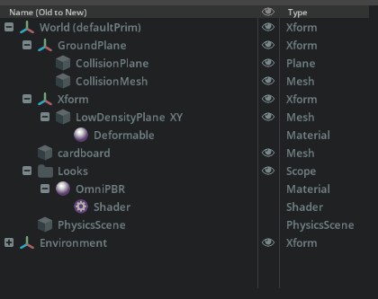

    Using Isaac Sim 5.0.0, I am aiming to implement an object that mimics a seal or sticker, possessing both the properties of flexible deformation (paper-like behavior) and adhesion to other objects.
    Currently, I have successfully achieved the flexible deformation property, but I am facing a challenge in effectively simulating the adhesion/stickiness property (Adhesion) when the object comes into contact with other surfaces.

    Object Setup: Please refer to the attached image. (Configured as a Soft Body/Deformable Body)

    Problem:
    The object is set up as a deformable soft body. However, when it is brought into contact with another surface (e.g., a flat plate), the expected adhesion/stickiness does not occur, and the object easily slides off or separates.

Hi @kazushi-uchida, thank you for posting your question. The materials property should be able to get the object to be more sticky. I will try to reproduce this and give you a solution. In the meantime, can you try to increase the make the physics timestep smaller? It helps with making simulation fidelity higher for thin deformable objects.
You can do that by changing the Timesteps Per Second in physics scene to 120 or 240.
Thank you for the suggestion.
I’ve tried increasing the Timesteps Per Second to 240 as you suggested, but unfortunately, I haven’t quite achieved the desired stickiness yet.
Based on the settings in the attached image, I suspect the parameters for Adhesion (10000.0) and Cohesion (10000.0) are directly related to the sticking property.
Therefore, I adjusted these values, but I was unable to reproduce the adhesion.
I look forward to hearing about the solution once you have been able to reproduce and resolve the issue.
@kazushi-uchida based on some experiments, it seems like the best solution is to use ClothPrim rather than deformables. Here is a video of what I got to work with ClothPrim + setting the Particle Material.

I was able to successfully verify the functionality, thanks to your assistance. I really appreciate your advice.
