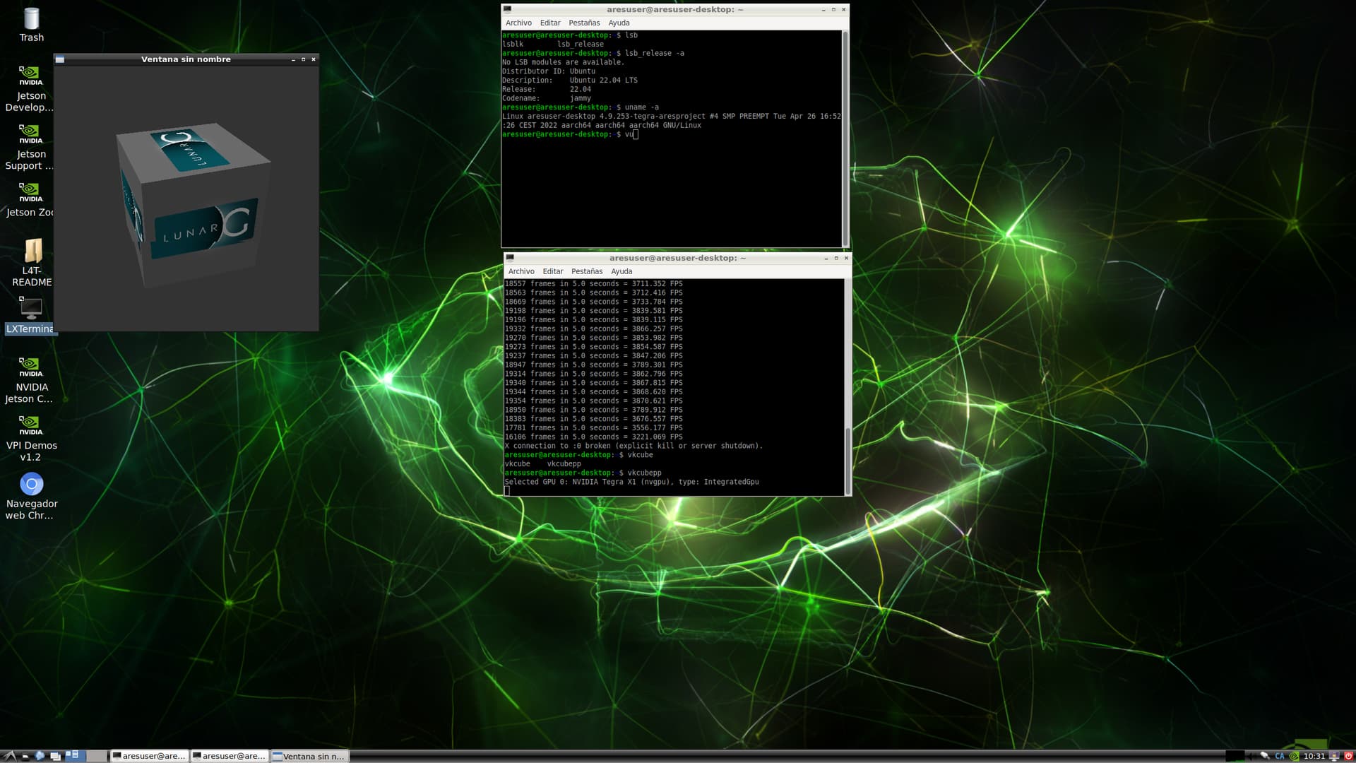

running Ubuntu 22.04 with LXDE with GPU blobs fine
With LXDE I get about around 3800 fps with glxgears with the CPU at 2.0ghz and gpu having PCIE enabling performance mode compiled into the kernel.
