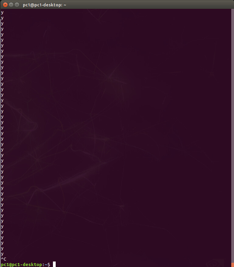

Thank you for replying Maciek. I’ve tried qemu but it doesn’t work.
when I type ‘yes’ after prompt following happens
when I type sudo apt-get install qemu this happens:
please help thanks.
