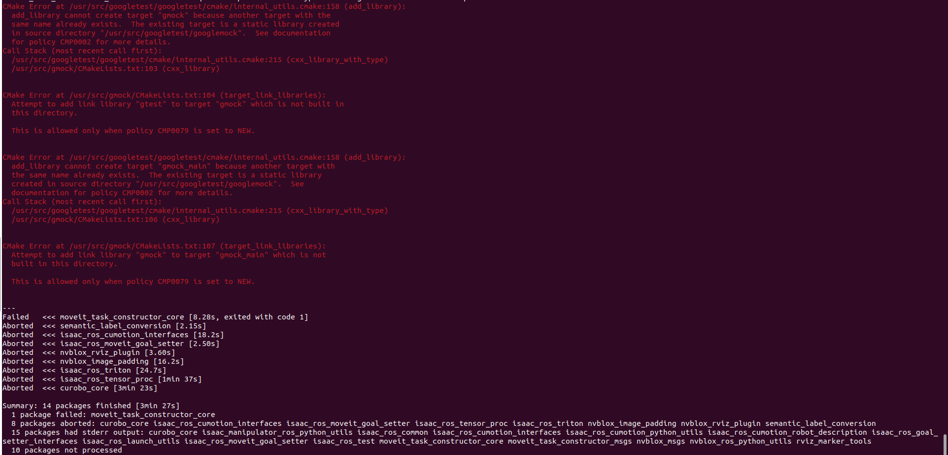

My environment is CUDA 12.8, but I also encounter the same issue.
Hi @pu9730962
Could you provide more detail info about your setup?
Best,
Ahung

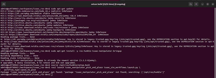

I followed the tutorial to install everything, but when running colcon build --symlink-install --packages-up-to isaac_manipulator_bringup, the following log appears.
Then, when I run the command:
ros2 launch isaac_manipulator_pick_and_place isaac_sim_workflows.launch.py workflow_type:=pick_and_place object_attachment_type:=sphere use_pose_from_rviz:=True
It shows the message:
Package ‘isaac_manipulator_pick_and_place’ not found: "package ‘isaac_manipulator_pick_and_place’ not found
When running colcon build --symlink-install --packages-up-to isaac_manipulator_bringup, the following log appears. Has anyone else encountered the same issue and managed to solve it ?
Even if I switch to Installation from Debian, when I run ros2 launch isaac_manipulator_pick_and_place isaac_sim_workflows.launch.py workflow_type:=pick_and_place object_attachment_type:=sphere use_pose_from_rviz:=True, I still get the error: Package 'isaac_manipulator_pick_and_place' not found: package 'isaac_manipulator_pick_and_place' not found, searching: ['/opt/ros/humble'].
I have recorded the complete log after running colcon build --symlink-install --packages-up-to isaac_manipulator_bringup, and I hope you can help me troubleshoot the errors.

--- stderr: moveit_task_constructor_core
moveit_task_constructor_core: You did not request a specific build type: Choosing 'Release' for maximum performance
CMake Warning at /opt/ros/humble/share/ament_cmake_gmock/cmake/ament_cmake_gmock-extras.cmake:110 (message):
  'gmock' not found, C++ tests using 'Google Mock' can not be built.  Please
  install the 'Google Mock' headers globally in your system to enable these
  tests (e.g.  on Ubuntu/Debian install the package 'google-mock') or get the
  ament package 'gmock_vendor'
Call Stack (most recent call first):
  /opt/ros/humble/share/ament_cmake_gmock/cmake/ament_find_gmock.cmake:32 (_ament_cmake_gmock_find_gmock)
  test/CMakeLists.txt:10 (ament_find_gmock)
CMake Error at test/CMakeLists.txt:36 (target_link_libraries):
  Cannot specify link libraries for target
  "moveit_task_constructor_core-test-mockups" which is not built by this
  project.
  test/CMakeLists.txt:42 (mtc_add_test)
  test/CMakeLists.txt:45 (mtc_add_gmock)
Failed   <<< moveit_task_constructor_core [8.10s, exited with code 1]
Aborted  <<< isaac_ros_moveit_goal_setter [3.17s]
Aborted  <<< semantic_label_conversion [2.15s]
Aborted  <<< isaac_ros_cumotion_interfaces [20.5s]
Aborted  <<< nvblox_rviz_plugin [5.56s]
Aborted  <<< isaac_manipulator_interfaces [19.3s]
Aborted  <<< nvblox_image_padding [20.8s]
Aborted  <<< curobo_core [3min 50s]
Summary: 15 packages finished [3min 55s]
  1 package failed: moveit_task_constructor_core
  7 packages aborted: curobo_core isaac_manipulator_interfaces isaac_ros_cumotion_interfaces isaac_ros_moveit_goal_setter nvblox_image_padding nvblox_rviz_plugin semantic_label_conversion
  16 packages had stderr output: curobo_core isaac_manipulator_interfaces isaac_manipulator_ros_python_utils isaac_ros_common isaac_ros_cumotion_interfaces isaac_ros_cumotion_python_utils isaac_ros_cumotion_robot_description isaac_ros_goal_setter_interfaces isaac_ros_launch_utils isaac_ros_moveit_goal_setter isaac_ros_test moveit_task_constructor_core moveit_task_constructor_msgs nvblox_msgs nvblox_ros_python_utils rviz_marker_tools
  11 packages not processed

Finished <<< moveit_task_constructor_msgs [0.67s]
Starting >>> moveit_task_constructor_core
Finished <<< nvblox_ros_common [3.72s]
Starting >>> nvblox_image_padding
--- stderr: nvblox_msgs
ERROR setuptools_scm._file_finders.git listing git files failed - pretending there aren't any
Finished <<< nvblox_msgs [3.79s]
Starting >>> nvblox_rviz_plugin
Finished <<< nvblox_image_padding [0.57s]
Starting >>> semantic_label_conversion
Finished <<< semantic_label_conversion [0.42s]
--- stderr: isaac_ros_goal_setter_interfaces
Finished <<< isaac_ros_goal_setter_interfaces [4.72s]
Starting >>> isaac_ros_moveit_goal_setter
--- stderr: isaac_ros_cumotion_interfaces
Finished <<< isaac_ros_cumotion_interfaces [5.41s]
--- stderr: isaac_ros_launch_utils
Finished <<< isaac_ros_launch_utils [5.98s]
Starting >>> isaac_ros_test_cmake
--- stderr: isaac_ros_cumotion_robot_description
Finished <<< isaac_ros_cumotion_robot_description [6.07s]
--- stderr: isaac_ros_cumotion_python_utils
Finished <<< isaac_ros_cumotion_python_utils [6.09s]
Finished <<< isaac_ros_test_cmake [0.16s]
--- stderr: nvblox_ros_python_utils
Finished <<< nvblox_ros_python_utils [6.14s]
--- stderr: isaac_manipulator_ros_python_utils
Finished <<< isaac_manipulator_ros_python_utils [6.21s]
--- stderr: isaac_ros_test
Finished <<< isaac_ros_test [6.29s]
  project.
Failed   <<< moveit_task_constructor_core [6.72s, exited with code 1]
Aborted  <<< curobo_core [6.82s]
Aborted  <<< isaac_ros_moveit_goal_setter [2.58s]
Aborted  <<< nvblox_rviz_plugin [16.1s]
Summary: 16 packages finished [20.9s]
  3 packages aborted: curobo_core isaac_ros_moveit_goal_setter nvblox_rviz_plugin
  13 packages had stderr output: isaac_manipulator_ros_python_utils isaac_ros_common isaac_ros_cumotion_interfaces isaac_ros_cumotion_python_utils isaac_ros_cumotion_robot_description isaac_ros_goal_setter_interfaces isaac_ros_launch_utils isaac_ros_moveit_goal_setter isaac_ros_test moveit_task_constructor_core moveit_task_constructor_msgs nvblox_msgs nvblox_ros_python_utils
  9 packages not processed
Hi @pu9730962
It looks that your build was failed with moveit_task_constructor_core
I followed the tutorial and the build can complete. However, my build log doesn’t show anything related to moveit_task_constructor_core. If this is in your source folder, please remove it and build again.
Best,
Ahung
