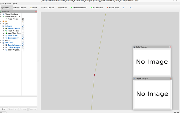

Isaac ROS nvblox ZED example crashes + TF lookup to zed_camera_link (Ubuntu 22.04, Humble, ZED SDK 5.0.2, RTX 4070 Laptop, ZED 2i)
Setup
  • OS: Ubuntu 22.04.5 LTS
  • ROS 2: Humble
  • GPU: RTX 4070 Laptop
  • NVIDIA driver: 570.169
  • CUDA: 12.8
  • Camera: ZED 2i
  • ZED SDK: 5.0.5
  • Isaac ROS: isaac_ros_nvblox + nvblox_examples_bringup
What works
  • ZED SDK: ZED_Explorer shows stereo live feed and metadata (see screenshot).
  • Isaac ROS Visual SLAM: runs and produces a cloud/trajectory (RViz screenshot attached).
What fails
Launching the ZED nvblox example:
ros2 launch nvblox_examples_bringup zed_example.launch.py camera:=zed2
Results:
  • Repeated TF errors in nvblox_node:
[nvblox_node]: Lookup transform failed for frame zed_camera_link. Layer pointclouds not published
[nvblox_node]: Tried to clear map outside of radius but couldn't look up frame: zed_camera_link
Eventually the ZED node sometimes logs:
[zed.zed_node]: Error opening camera: CAMERA STREAM FAILED TO START
[zed.zed_node]: Please verify the camera connection
[zed.zed_node]: Camera detection timeout
I am tring to run Nvblox which i’ll eventually run along with segmentation for creating memory map but nvblox seem not to run. I found this link Nvblox_examples_bringup isnt working - #16 by smokemonkey101 useful as it was the similar issue but it doesn’t solve my problem as it doesn’t run for 10 mins but crashes.
Zed 2 works inside the container
Vslam works
Nvblxox doesnt work.

[INFO] [launch_ros.actions.load_composable_nodes]: Loaded node '/nvblox_node' in container 'nvblox_container'
[component_container_mt-1] [INFO] [1755494542.007429674] [nvblox_node]: Tried to clear map outside of radius but couldn't look up frame: zed_camera_link
[component_container_mt-1] [INFO] [1755494542.007622448] [nvblox_node]: Lookup transform failed for frame zed_camera_link. Layer pointclouds not published
[component_container_mt-1] [INFO] [1755494542.046861254] [zed.zed_node]: ZED SDK Version: 5.0.5 - Build 103094_e8068fce
[component_container_mt-1] [INFO] [1755494542.053169430] [zed.zed_node]: *** CAMERA OPENING ***
[component_container_mt-1] [2025-08-18 05:22:22 UTC][ZED][INFO] Logging level INFO
[component_container_mt-1] [WARN] [1755494542.762284842] [zed.zed_node]: Error opening camera: CAMERA STREAM FAILED TO START
[component_container_mt-1] [INFO] [1755494542.762320361] [zed.zed_node]: Please verify the camera connection
[component_container_mt-1] [2025-08-18 05:22:22 UTC][ZED][WARNING] CAMERA STREAM FAILED TO START in sl::ERROR_CODE sl::Camera::open(sl::InitParameters)
[component_container_mt-1] [INFO] [1755494543.017330673] [nvblox_node]: Tried to clear map outside of radius but couldn't look up frame: zed_camera_link
[component_container_mt-1] [INFO] [1755494543.037407164] [nvblox_node]: Lookup transform failed for frame zed_camera_link. Layer pointclouds not published
[component_container_mt-1] [INFO] [1755494544.027442217] [nvblox_node]: Tried to clear map outside of radius but couldn't look up frame: zed_camera_link
[component_container_mt-1] [INFO] [1755494544.067424139] [nvblox_node]: Lookup transform failed for frame zed_camera_link. Layer pointclouds not published
[component_container_mt-1] [INFO] [1755494545.027539886] [nvblox_node]: Tried to clear map outside of radius but couldn't look up frame: zed_camera_link
[component_container_mt-1] [INFO] [1755494545.087473868] [nvblox_node]: Lookup transform failed for frame zed_camera_link. Layer pointclouds not published
[component_container_mt-1] [INFO] [1755494546.037400236] [nvblox_node]: Tried to clear map outside of radius but couldn't look up frame: zed_camera_link
[component_container_mt-1] [INFO] [1755494546.107447563] [nvblox_node]: Lookup transform failed for frame zed_camera_link. Layer pointclouds not published
[component_container_mt-1] [INFO] [1755494547.037411089] [nvblox_node]: Tried to clear map outside of radius but couldn't look up frame: zed_camera_link
[component_container_mt-1] [INFO] [1755494547.147415267] [nvblox_node]: Lookup transform failed for frame zed_camera_link. Layer pointclouds not published
[component_container_mt-1] [INFO] [1755494548.037446546] [nvblox_node]: Tried to clear map outside of radius but couldn't look up frame: zed_camera_link
[component_container_mt-1] [INFO] [1755494548.167422473] [nvblox_node]: Lookup transform failed for frame zed_camera_link. Layer pointclouds not published
[component_container_mt-1] [2025-08-18 05:22:28 UTC][ZED][INFO] Logging level INFO
[component_container_mt-1] [WARN] [1755494548.472506760] [zed.zed_node]: Error opening camera: CAMERA STREAM FAILED TO START
[component_container_mt-1] [INFO] [1755494548.472576698] [zed.zed_node]: Please verify the camera connection
[component_container_mt-1] [2025-08-18 05:22:28 UTC][ZED][WARNING] CAMERA STREAM FAILED TO START in sl::ERROR_CODE sl::Camera::open(sl::InitParameters)
[component_container_mt-1] [INFO] [1755494549.047490424] [nvblox_node]: Tried to clear map outside of radius but couldn't look up frame: zed_camera_link
[component_container_mt-1] [INFO] [1755494549.197482680] [nvblox_node]: Lookup transform failed for frame zed_camera_link. Layer pointclouds not published
[component_container_mt-1] [INFO] [1755494550.057467872] [nvblox_node]: Tried to clear map outside of radius but couldn't look up frame: zed_camera_link
[component_container_mt-1] [INFO] [1755494550.227815913] [nvblox_node]: Lookup transform failed for frame zed_camera_link. Layer pointclouds not published
[component_container_mt-1] [INFO] [1755494551.057538013] [nvblox_node]: Tried to clear map outside of radius but couldn't look up frame: zed_camera_link
[component_container_mt-1] [INFO] [1755494551.267474450] [nvblox_node]: Lookup transform failed for frame zed_camera_link. Layer pointclouds not published
[component_container_mt-1] [INFO] [1755494552.057655598] [nvblox_node]: Tried to clear map outside of radius but couldn't look up frame: zed_camera_link
[component_container_mt-1] [INFO] [1755494552.297517158] [nvblox_node]: Lookup transform failed for frame zed_camera_link. Layer pointclouds not published
[component_container_mt-1] [INFO] [1755494553.057703684] [nvblox_node]: Tried to clear map outside of radius but couldn't look up frame: zed_camera_link
[component_container_mt-1] [INFO] [1755494553.327535004] [nvblox_node]: Lookup transform failed for frame zed_camera_link. Layer pointclouds not published
[component_container_mt-1] [2025-08-18 05:22:33 UTC][ZED][INFO] Logging level INFO
[component_container_mt-1] [INFO] [1755494554.067838342] [nvblox_node]: Tried to clear map outside of radius but couldn't look up frame: zed_camera_link
[component_container_mt-1] [WARN] [1755494554.180748716] [zed.zed_node]: Error opening camera: CAMERA STREAM FAILED TO START
[component_container_mt-1] [INFO] [1755494554.180799736] [zed.zed_node]: Please verify the camera connection
[component_container_mt-1] [2025-08-18 05:22:34 UTC][ZED][WARNING] CAMERA STREAM FAILED TO START in sl::ERROR_CODE sl::Camera::open(sl::InitParameters)
[component_container_mt-1] [INFO] [1755494554.347523561] [nvblox_node]: Lookup transform failed for frame zed_camera_link. Layer pointclouds not published
[component_container_mt-1] [INFO] [1755494555.077516723] [nvblox_node]: Tried to clear map outside of radius but couldn't look up frame: zed_camera_link
[component_container_mt-1] [INFO] [1755494555.377565572] [nvblox_node]: Lookup transform failed for frame zed_camera_link. Layer pointclouds not published
[component_container_mt-1] [INFO] [1755494556.077553720] [nvblox_node]: Tried to clear map outside of radius but couldn't look up frame: zed_camera_link
[component_container_mt-1] [INFO] [1755494556.397621975] [nvblox_node]: Lookup transform failed for frame zed_camera_link. Layer pointclouds not published
[component_container_mt-1] [INFO] [1755494557.077597505] [nvblox_node]: Tried to clear map outside of radius but couldn't look up frame: zed_camera_link
[component_container_mt-1] [INFO] [1755494557.417552721] [nvblox_node]: Lookup transform failed for frame zed_camera_link. Layer pointclouds not published
[component_container_mt-1] [INFO] [1755494558.087615380] [nvblox_node]: Tried to clear map outside of radius but couldn't look up frame: zed_camera_link
[component_container_mt-1] [INFO] [1755494558.457584016] [nvblox_node]: Lookup transform failed for frame zed_camera_link. Layer pointclouds not published
[component_container_mt-1] [INFO] [1755494559.097575962] [nvblox_node]: Tried to clear map outside of radius but couldn't look up frame: zed_camera_link
[component_container_mt-1] [INFO] [1755494559.467619329] [nvblox_node]: Lookup transform failed for frame zed_camera_link. Layer pointclouds not published
[component_container_mt-1] [2025-08-18 05:22:39 UTC][ZED][INFO] Logging level INFO
[component_container_mt-1] [WARN] [1755494559.890667214] [zed.zed_node]: Error opening camera: CAMERA STREAM FAILED TO START
[component_container_mt-1] [INFO] [1755494559.890723294] [zed.zed_node]: Please verify the camera connection
[component_container_mt-1] [2025-08-18 05:22:39 UTC][ZED][WARNING] CAMERA STREAM FAILED TO START in sl::ERROR_CODE sl::Camera::open(sl::InitParameters)
[component_container_mt-1] [INFO] [1755494560.097629175] [nvblox_node]: Tried to clear map outside of radius but couldn't look up frame: zed_camera_link
[component_container_mt-1] [INFO] [1755494560.497708921] [nvblox_node]: Lookup transform failed for frame zed_camera_link. Layer pointclouds not published
[component_container_mt-1] [INFO] [1755494561.097657219] [nvblox_node]: Tried to clear map outside of radius but couldn't look up frame: zed_camera_link
[component_container_mt-1] [INFO] [1755494561.527762868] [nvblox_node]: Lookup transform failed for frame zed_camera_link. Layer pointclouds not published
[component_container_mt-1] [INFO] [1755494562.107960576] [nvblox_node]: Tried to clear map outside of radius but couldn't look up frame: zed_camera_link
[component_container_mt-1] [INFO] [1755494562.567753440] [nvblox_node]: Lookup transform failed for frame zed_camera_link. Layer pointclouds not published
[component_container_mt-1] [INFO] [1755494563.117722815] [nvblox_node]: Tried to clear map outside of radius but couldn't look up frame: zed_camera_link
[component_container_mt-1] [INFO] [1755494563.587995543] [nvblox_node]: Lookup transform failed for frame zed_camera_link. Layer pointclouds not published
[component_container_mt-1] [INFO] [1755494564.637693621] [nvblox_node]: Lookup transform failed for frame zed_camera_link. Layer pointclouds not published
[component_container_mt-1] [INFO] [1755494565.127665738] [nvblox_node]: Tried to clear map outside of radius but couldn't look up frame: zed_camera_link
[component_container_mt-1] [2025-08-18 05:22:45 UTC][ZED][INFO] Logging level INFO
[component_container_mt-1] [WARN] [1755494565.600030128] [zed.zed_node]: Error opening camera: CAMERA STREAM FAILED TO START
[component_container_mt-1] [INFO] [1755494565.600065900] [zed.zed_node]: Please verify the camera connection
[component_container_mt-1] [2025-08-18 05:22:45 UTC][ZED][WARNING] CAMERA STREAM FAILED TO START in sl::ERROR_CODE sl::Camera::open(sl::InitParameters)
[component_container_mt-1] [INFO] [1755494565.657852305] [nvblox_node]: Lookup transform failed for frame zed_camera_link. Layer pointclouds not published
[component_container_mt-1] [INFO] [1755494566.127724559] [nvblox_node]: Tried to clear map outside of radius but couldn't look up frame: zed_camera_link
[component_container_mt-1] [INFO] [1755494566.687730007] [nvblox_node]: Lookup transform failed for frame zed_camera_link. Layer pointclouds not published
[component_container_mt-1] [INFO] [1755494567.127745752] [nvblox_node]: Tried to clear map outside of radius but couldn't look up frame: zed_camera_link
[component_container_mt-1] [INFO] [1755494567.707907024] [nvblox_node]: Lookup transform failed for frame zed_camera_link. Layer pointclouds not published
[component_container_mt-1] [INFO] [1755494568.127758502] [nvblox_node]: Tried to clear map outside of radius but couldn't look up frame: zed_camera_link
[component_container_mt-1] [INFO] [1755494568.747748507] [nvblox_node]: Lookup transform failed for frame zed_camera_link. Layer pointclouds not published
[component_container_mt-1] [INFO] [1755494569.127892510] [nvblox_node]: Tried to clear map outside of radius but couldn't look up frame: zed_camera_link
[component_container_mt-1] [INFO] [1755494569.777784399] [nvblox_node]: Lookup transform failed for frame zed_camera_link. Layer pointclouds not published
[component_container_mt-1] [INFO] [1755494570.137773737] [nvblox_node]: Tried to clear map outside of radius but couldn't look up frame: zed_camera_link
[component_container_mt-1] [INFO] [1755494570.798069146] [nvblox_node]: Lookup transform failed for frame zed_camera_link. Layer pointclouds not published
[component_container_mt-1] [2025-08-18 05:22:51 UTC][ZED][INFO] Logging level INFO
[component_container_mt-1] [INFO] [1755494571.138176128] [nvblox_node]: Tried to clear map outside of radius but couldn't look up frame: zed_camera_link
[component_container_mt-1] [WARN] [1755494571.312091526] [zed.zed_node]: Error opening camera: CAMERA STREAM FAILED TO START
[component_container_mt-1] [INFO] [1755494571.312156389] [zed.zed_node]: Please verify the camera connection
[component_container_mt-1] [ERROR] [1755494571.312170665] [zed.zed_node]: Camera detection timeout
[component_container_mt-1] [2025-08-18 05:22:51 UTC][ZED][WARNING] CAMERA STREAM FAILED TO START in sl::ERROR_CODE sl::Camera::open(sl::InitParameters)
[component_container_mt-1] malloc_consolidate(): unaligned fastbin chunk detected
[ERROR] [component_container_mt-1]: process has died [pid 43443, exit code -6, cmd '/opt/ros/humble/lib/rclcpp_components/component_container_mt --ros-args --log-level info --ros-args -r __node:=nvblox_container'].
[INFO] [launch]: process[component_container_mt-1] was required: shutting down launched system
[INFO] [rviz2-3]: sending signal 'SIGINT' to process[rviz2-3]
[INFO] [robot_state_publisher-2]: sending signal 'SIGINT' to process[robot_state_publisher-2]
[rviz2-3] [INFO] [1755494572.020866090] [rclcpp]: signal_handler(signum=2)
[robot_state_publisher-2] [INFO] [1755494572.021249543] [rclcpp]: signal_handler(signum=2)
[INFO] [robot_state_publisher-2]: process has finished cleanly [pid 43445]
[ERROR] [rviz2-3]: process[rviz2-3] failed to terminate '5' seconds after receiving 'SIGINT', escalating to 'SIGTERM'
[INFO] [rviz2-3]: sending signal 'SIGTERM' to process[rviz2-3]
[rviz2-3] [INFO] [1755494577.026292383] [rclcpp]: signal_handler(signum=15)
[ERROR] [rviz2-3]: process[rviz2-3] failed to terminate '10.0' seconds after receiving 'SIGTERM', escalating to 'SIGKILL'
[INFO] [rviz2-3]: sending signal 'SIGKILL' to process[rviz2-3]
[ERROR] [rviz2-3]: process has died [pid 43447, exit code -9, cmd '/opt/ros/humble/lib/rviz2/rviz2 -d /opt/ros/humble/share/nvblox_examples_bringup/config/visualization/zed_example.rviz --ros-args'].
admin@mab-Dell-G16-7630:/workspaces/isaac_ros-dev$
Hi @engineer.ambarishgk
Thank you for your post!
About this error, could you check if following post can resolve your issue?
Best,
Ahung
