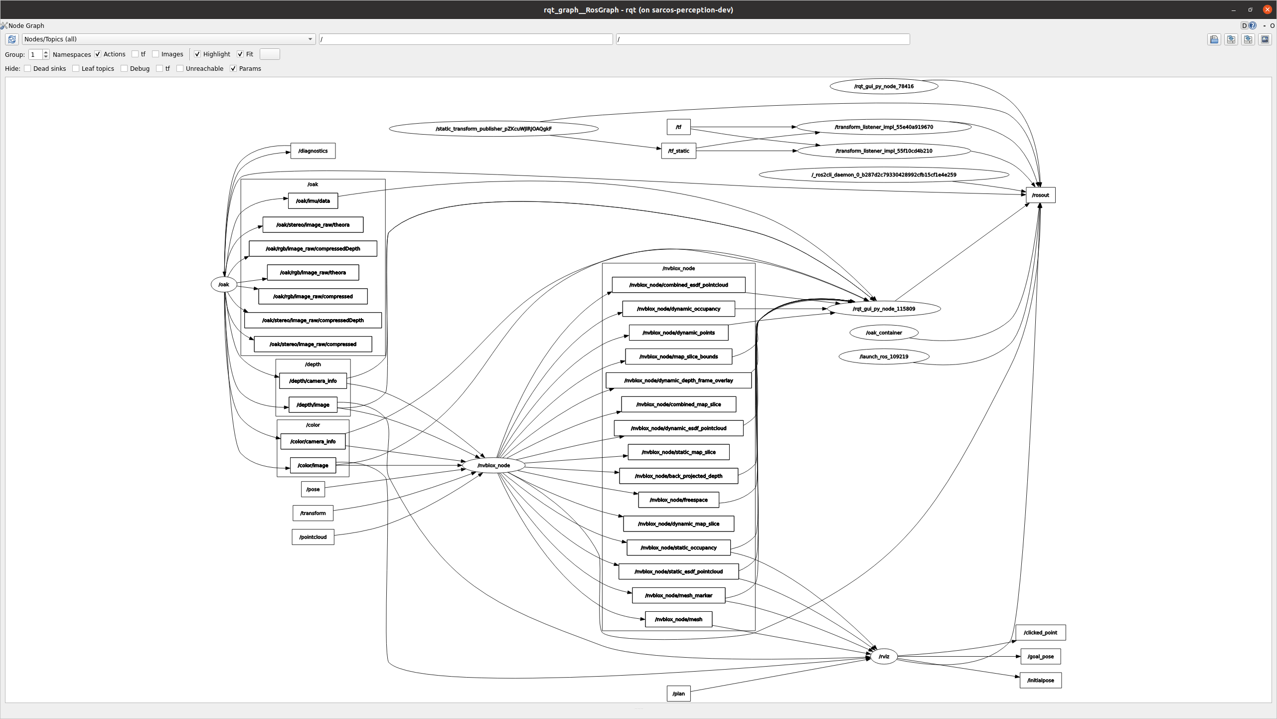

Then because we are not using the bag data I set use_sim_time to False:
ros2 param set /nvblox_node use_sim_time False
Then, when running my camera launch, I get output that suggests the messages are being received but no output topics publish anything meaningful.

[component_container_mt-1] [WARN] [1708013621.048144346] [tf2_buffer]: Detected time source change. Clearing TF buffer.
[component_container_mt-1] [INFO] [1708013621.119221657] [nvblox_node]: Depth Statistics:
[component_container_mt-1] avg=nan, min=nan, max=nan, std_dev=nan, count=0
[component_container_mt-1] [INFO] [1708013621.122293758] [nvblox_node]: depth queue was longer than 30 deleted 1 messages.
[component_container_mt-1] [INFO] [1708013622.142110232] [nvblox_node]: depth queue was longer than 30 deleted 1 messages.
[component_container_mt-1] [INFO] [1708013623.162235484] [nvblox_node]: depth queue was longer than 30 deleted 1 messages.
[component_container_mt-1] [INFO] [1708013624.192563258] [nvblox_node]: depth queue was longer than 30 deleted 1 messages.
[component_container_mt-1] [INFO] [1708013625.222149530] [nvblox_node]: depth queue was longer than 30 deleted 1 messages.
[component_container_mt-1] [INFO] [1708013626.322126894] [nvblox_node]: depth queue was longer than 30 deleted 1 messages.
[component_container_mt-1] [INFO] [1708013627.482145718] [nvblox_node]: depth queue was longer than 30 deleted 1 messages.
[component_container_mt-1] [INFO] [1708013628.562258029] [nvblox_node]: depth queue was longer than 30 deleted 1 messages.
[component_container_mt-1] [INFO] [1708013629.572828892] [nvblox_node]: depth queue was longer than 30 deleted 1 messages.
[component_container_mt-1] [INFO] [1708013630.632235549] [nvblox_node]: depth queue was longer than 30 deleted 1 messages.
[component_container_mt-1] [INFO] [1708013631.121398977] [nvblox_node]: Depth Statistics:
[component_container_mt-1] avg=82.663232, min=22.180779, max=241.557170, std_dev=38.503534, count=121
[component_container_mt-1] [INFO] [1708013631.722399435] [nvblox_node]: depth queue was longer than 30 deleted 1 messages.
[component_container_mt-1] [INFO] [1708013632.752406449] [nvblox_node]: depth queue was longer than 30 deleted 1 messages.
[component_container_mt-1] [INFO] [1708013633.812412415] [nvblox_node]: depth queue was longer than 30 deleted 1 messages.
[component_container_mt-1] [INFO] [1708013634.892286137] [nvblox_node]: depth queue was longer than 30 deleted 1 messages.
[component_container_mt-1] [INFO] [1708013635.892553643] [nvblox_node]: depth queue was longer than 30 deleted 1 messages.
[component_container_mt-1] [INFO] [1708013636.922265329] [nvblox_node]: depth queue was longer than 30 deleted 1 messages.
[component_container_mt-1] [INFO] [1708013637.942252961] [nvblox_node]: depth queue was longer than 30 deleted 1 messages.
[component_container_mt-1] [INFO] [1708013638.962245488] [nvblox_node]: depth queue was longer than 30 deleted 1 messages.
For example, here is a message from /nvblox_node/static_esdf_pointcloud:
header:
stamp:
sec: 1708014833
nanosec: 237362703
frame_id: odom
height: 0
width: 0
fields: []
is_bigendian: false
point_step: 0
row_step: 0
data: []
is_dense: false
