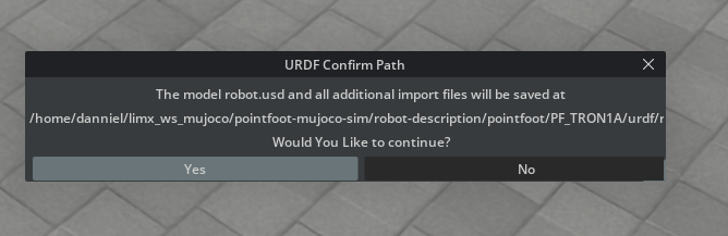

If the URDF or XML file contains STL or OBJ files, the urdf import or mjcf import won’t work, and the log shows that the extension gets stuck when processing 3D files.

2025-02-26 07:59:01 [58,787ms] [Info] [isaacsim.asset.importer.urdf] Found Mesh At: /home/danniel/limx_ws_mujoco/pointfoot-mujoco-sim/robot-description/pointfoot/PF_TRON1A/urdf/../new_meshes/abad_L_Link.STL (/visuals/abad_L_Link/abad_L_Link)
2025-02-26 07:59:01 [58,787ms] [Info] [isaacsim.asset.importer.urdf] Importing Mesh /meshes/abad_L_Link /home/danniel/limx_ws_mujoco/pointfoot-mujoco-sim/robot-description/pointfoot/PF_TRON1A/urdf/../new_meshes/abad_L_Link.STL
(/home/danniel/limx_ws_mujoco/pointfoot-mujoco-sim/robot-description/pointfoot/PF_TRON1A/new_meshes/abad_L_Link.STL)
2025-02-26 07:59:01 [58,788ms] [Info] [isaacsim.asset.importer.urdf] Starting to import asset with Assimp importer.
Screenshots or Videos
isaacsim app gets stuck

I’ve used both custom and official XML and URDF files, but the result is the same. It seems that there are issues with the Isaac Sim 4.5 urdf or mjcf import extension when processing 3D modeling files.
the official urdf files didn’t work either:

Please try running Isaac Sim with a fresh config by using the --reset-user flag, which worked for a developer as mentioned in Isaac Sim 4.5.0 not responding at URDF Import - #3 by ar.avishekdas.
Thanks a lot ! It works now!
Thank you so much for your help! I can import it normally now. Many thanks!
