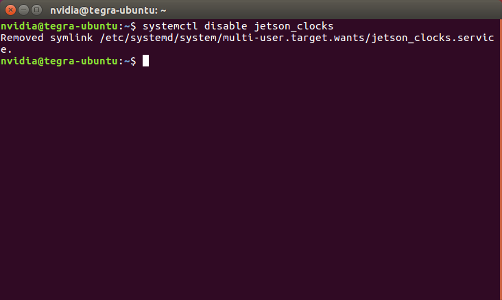

Hi everyone,
I got the response from Stereolabs Support and my issue is gone!
Here is part of the email explaining the reason how to handle it.
The ZED SDK installer gives you the possibility to set the Jetson in maximum performance mode.
This makes sure the Jetson is ready to run the ZED SDK and your programs at the maximum of its capabilities.
To disable this, you can run
systemctl disable jetson_clocks
and reboot.
I ran the single line command and my world become peace again…
Thank you!
