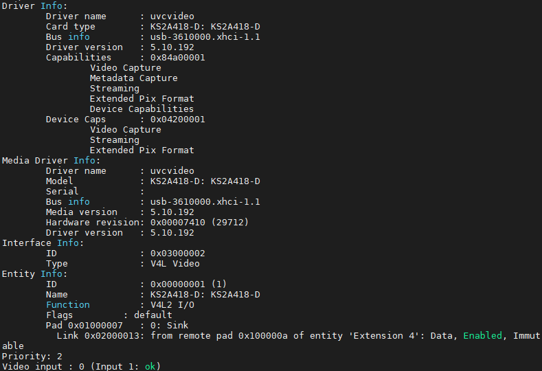

Issues Testing Gstreamer RTSP Server with USB Camera and Hardware Encoding on Jetson Orin Nx
Hello, I recently attempted to build a hardware-encoded RTSP service using GStreamer on the Jetson Orin Nx and encountered some issues. It would be greatly appreciated if you could provide some troubleshooting insights.
Platform Information:
USB Camera Details:
Software Encoding Test:

Result:
  1. When using videotestsrc, VLC fails to open the stream properly on the first attempt but succeeds on the second attempt.
  2. When using v4l2src device=/dev/video0, VLC cannot open the stream normally.
Could you help me diagnose where the problem might lie?

I can’t figure out the cause of the problem.
Please try the command and see if you can get a good video file:
$ gst-launch-1.0 v4l2src device=/dev/video0 num-buffers=150 ! video/x-raw,format=YUY2,width=640,height=480,framerate=30/1 ! nvvidconv ! 'video/x-raw(memory:NVMM),format=(string)I420' ! nvv4l2h264enc ! h264parse ! matroskamux ! filesink location=a.mkv
I tried the command you provided, but it failed to generate a good video file:
xxx@ubuntu:~/gst-rtsp-server-1.16.3/examples$ gst-launch-1.0 v4l2src device=/dev/video0 num-buffers=150 ! video/x-raw,format=YUY2,width=640,height=480,framerate=30/1 ! nvvidconv ! 'video/x-raw(memory:NVMM),format=(string)I420' ! nvv4l2h264enc ! h264parse ! matroskamux ! filesink location=a.mkv
Opening in BLOCKING MODE
Pipeline is live and does not need PREROLL ...
ERROR: from element /GstPipeline:pipeline0/GstV4l2Src:v4l2src0: Internal data stream error.
Additional debug info:
gstbasesrc.c(3072): gst_base_src_loop (): /GstPipeline:pipeline0/GstV4l2Src:v4l2src0:
streaming stopped, reason not-negotiated (-4)
Execution ended after 0:00:00.000082801
Setting pipeline to NULL ...
Freeing pipeline ...
Hi, the error indicates the v4l2 source fails to run in 640*480p30 YUY2. Suggest check this.
Thank you very much for your solution. I have found the problem. I previously thought that as long as the set frame rate did not exceed the maximum frame rate of the USB camera, it would be fine, so I only set it to 30 FPS. However, when I changed it to 60 FPS, it played normally.
But there is still one last issue: why does VLC software always fail to connect on the first attempt and succeed on the second attempt after generating the RTSP service? The first connection failure is accompanied by the error output:
