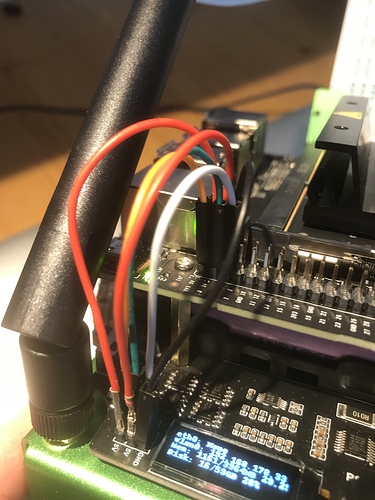

Finally I got it. Thanks to a colleague of mine, who fixed the problem of the wiring (see picture). He meassured the 6-pin plug and the blue wire did not operate.
I learned: if the OLED-Display works, the motors will do even so.

Be shure to use: jetbot_image_v0p4p0.zip
Forget about i2cdetect -y 2 or i2cdetect -y 1, this has nothing to say.
Forget about broken jetson board or motor control board, they are quite solid.
As you see my colleague used new wires and plugs, to solve the problem.
He is a good technician, maybe you have to go and find someone with experience in soldering.
Don’t give up, y o u are the human!
