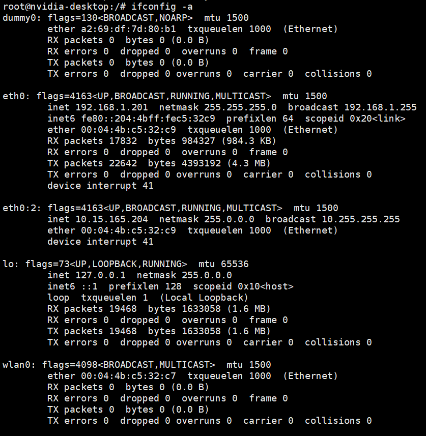

The following is the code modification of USB3.0 OTG in jetpack4.2.2 R32.2.1, after command(echo 0x2 > /sys/class/extcon/extcon0/state);(ifconfig -a)command Unable to discover device.
Please help me see how to solve it.
jetpack4.2.2-R32.2.1-hardware-nvidia-platform-t18x-common.patch.txt (2.4 KB) jetpack4.2.2-R32.2.1-hardware-nvidia-platform-t18x-quill.patch.txt (4.5 KB)

I follow these steps on the devit board(TX2), Can it work normally in usb3.0 rndis.
1.write correct dtb.
2.Plug in USB3.0 cable(type A),TX2 is device, PC(linux) is host.
3.echo 0x2 > /sys/class/extcon/extcon0/state
