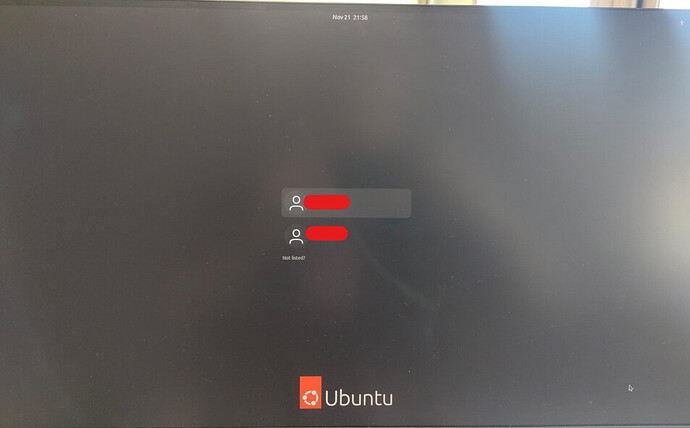

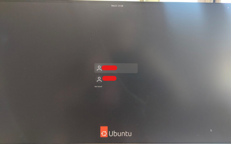

I tried to install Jetson 36.2 RT Kernel, and it seems to be well installed until i reach the ubuntu login, doesn’t work neither the keyboard nor the mouse.
The keyboard works because at boot menu i can access boot manager and setup.
hey, i put down the steps that i followed tell me if u see something. This week I do not have physical access to the board, when I have it I will do the dmesg with the serial console

So this one is not required. Actually I don’t even know what exactly you did here.
There is no single folder called /lib/modules/ in the kernel source tree even after compilation.
Of course it’s /.
Also, it’s better you name the new kernel image differently, and specify it in extlinux.conf.
So if it fails to load, you still have the stock kernel which should work properly.
