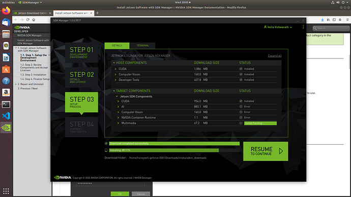

The same error persists after I deleted the mentioned file.
I’m being suggested not the select “Flash the OS” option during step 2.
Does that contribute to the error ? -
Earlier I did the installation with Jetpack, this time i am trying to NVDIA sdkmanager, is there is a difference between them. The goal is to install Tensorrt on Xavier kit.
With Jetson I was able to flash the packages to Xavier but was facing import error with TensorRT.
Yesterday I tried with SDK Manager, but while installing on Xavier, it is giving above mentioned error.

Based on your description, I’m afraid that the failure is caused by the incompatible software.
Could you try to setup the Xaiver with flash and installation at the same time, do not by-pass the OS steps.
Thanks and please let us know the result.

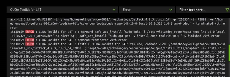

Here are some additional details regarding the error :
15:32:20 ERROR : Unavailable components detected, please check log
15:32:20 ERROR : cuDNN on Target : cuDNN on Target Skipped. Due to its dependencies fail to install: CUDA Toolkit for L4T,
15:32:20 ERROR : TensorRT on Target : TensorRT on Target Skipped. Due to its dependencies fail to install: CUDA Toolkit for L4T,
15:32:20 ERROR : OpenCV on Target : OpenCV on Target Skipped. Due to its dependencies fail to install: CUDA Toolkit for L4T,
15:32:20 ERROR : VisionWorks on Target : VisionWorks on Target Skipped. Due to its dependencies fail to install: CUDA Toolkit for L4T,
15:32:20 ERROR : Multimedia API : Multimedia API Skipped. Due to its dependencies fail to install: CUDA Toolkit for L4T,
14:00:25 ERROR : CUDA Toolkit for L4T : : command safe_apt_install “sudo dpkg -i /opt/nvidia/deb_repos/cuda-repo-l4t-10-0-local-10.0.326_1.0-1_arm64.deb” 5; sleep 5; ; safe_apt_install "sudo apt-get -y install cuda-toolkit-10-0 " 5 finished with error
14:00:25 ERROR : CUDA Toolkit for L4T : command terminated with error
14:00:25 ERROR : CUDA Toolkit for L4T : install ‘CUDA Toolkit for L4T’ failure, command < cd ‘/home/honeywell-geforce-0001/nvidia/nvidia_sdk/JetPack_4.2.3_Linux_GA_P2888’ ; ‘/opt/nvidia/sdkmanager/resources/app/output/installUtils/adapter’ -a=‘install’ -c=‘eyJpZCI6Ik5WX0w0VF9DVURBX1RBUkdFVF9QT1NUX0lOU1RBTExfQ09NUCIsIm5hbWUiOiJDVURBIFRvb2xraXQgZm9yIEw0VCIsImRlc2NyaXB0aW9uIjoiQ1VEQSB0byBiZSBpbnN0YWxsZWQgb24gdGFyZ2V0LiBDVURBIGlzIGEgcGFyYWxsZWwgY29tcHV0aW5nIHBsYXRmb3JtIGFuZCBwcm9ncmFtbWluZyBtb2RlbCBpbnZlbnRlZCBieSBOVklESUEuIEl0IGVuYWJsZXMgZHJhbWF0aWMgaW5jcmVhc2VzIGluIGNvbXB1dGluZyBwZXJmb3JtYW5jZSBieSBoYXJuZXNzaW5nIHRoZSBwb3dlciBvZiB0aGUgZ3JhcGhpY3MgcHJvY2Vzc2luZyB1bml0IChHUFUpLiIsImNvbXBUeXBlIjoidGFyZ2V0IiwiaXNWaXNpYmxlIjp0cnVlLCJsaWNlbnNlSWQiOiJOVl9KRVRQQUNLX0NVREFfRVVMQSIsImlzRGV0ZWN0YWJsZUluc3RhbGwiOmZhbHNlLCJpc0luc3RhbGxQYXRoQ3VzdG9taXphYmxlIjp0cnVlLCJ2ZXJzaW9uIjoiMTAuMCIsIm9wZXJhdGluZ1N5c3RlbXMiOlsidWJ1bnR1MTYwNCIsInVidW50dTE4MDQiXSwiaW5zdGFsbFNpemVNQiI6MCwiZG93bmxvYWRGaWxlcyI6W3sidXJsIjoiY3VkYS1yZXBvLWw0dC0xMC0wLWxvY2FsLTEwLjAuMzI2XzEuMC0xX2FybTY0LmRlYiIsImZpbGVOYW1lIjoiY3VkYS1yZXBvLWw0dC0xMC0wLWxvY2FsLTEwLjAuMzI2XzEuMC0xX2FybTY0LmRlYiIsInNpemUiOjEwMDAzMzMyOTIsImNoZWNrc3VtIjoiMGUxMmIyZjUzYzdjYmU0MjMzYzJkYTczZjdkOGU2YjQiLCJjaGVja3N1bVR5cGUiOiJtZDUiLCJpbnN0YWxsUGFyYW1ldGVycyI6eyJpbnN0YWxsVHlwZSI6InRhcmdldF9kZWJfcmVwbyIsImFkZGl0aW9uYWxQYXJhbWV0ZXJzIjp7InBhY2thZ2VzSW5mbyI6W3sibmFtZSI6ImN1ZGEtdG9vbGtpdC0xMC0wIiwidmVyc2lvbiI6IjEwLjAifV0sInBvc3RJbnN0YWxsQ29tbWFuZHMiOlt7InJlbW90ZUV4ZWNCYXNoIjpbInNhZmVfYXB0X2luc3RhbGwgXCJzdWRvIGFwdC1nZXQgaW5zdGFsbCAteSBnbnVwZyBsaWJnb21wMSBsaWJmcmVlaW1hZ2UtZGV2IGxpYm9wZW5tcGktZGV2IG9wZW5tcGktYmluXCIgNSIsImdyZXAgLXEgJ2V4cG9ydCBQQVRIPS4qL3Vzci9sb2NhbC9jdWRhLTEwLjAvYmluJyB+Ly5iYXNocmMgfHwgZWNobyAnZXhwb3J0IFBBVEg9L3Vzci9sb2NhbC9jdWRhLTEwLjAvYmluOiRQQVRIJz4+fi8uYmFzaHJjIiwiZ3JlcCAtcSAnZXhwb3J0IExEX0xJQlJBUllfUEFUSD0vdXNyL2xvY2FsL2N1ZGEtMTAuMC9saWI2NCcgfi8uYmFzaHJjIHx8IGVjaG8gJ2V4cG9ydCBMRF9MSUJSQVJZX1BBVEg9L3Vzci9sb2NhbC9jdWRhLTEwLjAvbGliNjQ6JExEX0xJQlJBUllfUEFUSCcgPj4gfi8uYmFzaHJjIl19XX19LCJjYWNoZWRVcmwiOiJodHRwczovL2RldmVsb3Blci5kb3dubG9hZC5udmlkaWEuY29tL2RldnpvbmUvZGV2Y2VudGVyL21vYmlsZS9qZXRwYWNrX2w0dC9KRVRQQUNLXzQyM19iNi9jdWRhLXJlcG8tbDR0LTEwLTAtbG9jYWwtMTAuMC4zMjZfMS4wLTFfYXJtNjQuZGViIiwiY3VycmVudERvd25sb2FkZWRVcmwiOiJodHRwczovL2RldmVsb3Blci5kb3dubG9hZC5udmlkaWEuY29tL2RldnpvbmUvZGV2Y2VudGVyL21vYmlsZS9qZXRwYWNrX2w0dC9KRVRQQUNLXzQyM19iNi9jdWRhLXJlcG8tbDR0LTEwLTAtbG9jYWwtMTAuMC4zMjZfMS4wLTFfYXJtNjQuZGViIn1dLCJ0YXJnZXRJZHMiOlsiUDI4ODgiLCJQMjg4OC0wMDYwIiwiUDMzMTAiLCJQMzQ4OS0wMDAwIiwiUDM0ODktMDA4MCIsIlAyMTgwIiwiUDM0NDgtMDAwMCIsIlAzNDQ4LTAwMjAiXSwiZGVwZW5kZW5jaWVzIjpbeyJpZCI6Ik5WX0w0VF9EQVRFVElNRV9UQVJHRVRfU0VUVVBfQ09NUCIsIm9wZXJhdG9yIjoiPT0iLCJ2ZXIiOiIxLjAiLCJfaWQiOiJOVl9MNFRfREFURVRJTUVfVEFSR0VUX1NFVFVQX0NPTVBAUDI4ODgifV0sImV4dGVybmFsX2RlcGVuZGVuY2llcyI6W10sInRhcmdldElEIjoiUDI4ODgiLCJfaWQiOiJOVl9MNFRfQ1VEQV9UQVJHRVRfUE9TVF9JTlNUQUxMX0NPTVBAUDI4ODgiLCJwYXJlbnRJRCI6Ik5WX0NVREFfVEFSR0VUX0dST1VQIiwiX3BhcmVudElEIjoiTlZfQ1VEQV9UQVJHRVRfR1JPVVBAUDI4ODgiLCJpbnN0YWxsU3RhdHVzIjoibm9uZSIsImFjdGlvbiI6MSwiZG93bmxvYWRFcnJvcnMiOltdLCJmaXJzdERvd25sb2FkRmlsZSI6Ii9ob21lL2hvbmV5d2VsbC1nZWZvcmNlLTAwMDEvRG93bmxvYWRzL252aWRpYS9zZGttX2Rvd25sb2Fkcy9jdWRhLXJlcG8tbDR0LTEwLTAtbG9jYWwtMTAuMC4zMjZfMS4wLTFfYXJtNjQuZGViIiwidGFyZ2V0QWNjZXNzSW5mbyI6eyJ1c2VyIjoibnZpZGlhIiwicGFzc3dvcmQiOiJudmlkaWEiLCJob3N0IjoiMTkyLjE2OC4xLjEwOCIsInBvcnQiOiIyMiJ9LCJidW5kbGVUaXRsZSI6IkpldFBhY2tfNC4yLjNfTGludXhfR0EiLCJpbnN0YWxsUGF0aCI6Ii9ob21lL2hvbmV5d2VsbC1nZWZvcmNlLTAwMDEvbnZpZGlhL252aWRpYV9zZGsvSmV0UGFja180LjIuM19MaW51eF9HQV9QMjg4OCIsImluc3RhbGxSb290IjoiL2hvbWUvaG9uZXl3ZWxsLWdlZm9yY2UtMDAwMS9udmlkaWEvbnZpZGlhX3NkayIsImJvYXJkSUQiOiJQMjg4OCIsImlzRHJ5UnVuIjpmYWxzZX0=’ -i=‘NV_L4T_CUDA_TARGET_POST_INSTALL_COMP’ -v=‘10.0’ -l=‘/home/honeywell-geforce-0001/nvidia/nvidia_sdk/JetPack_4.2.3_Linux_GA_P2888’ -L=‘/home/honeywell-geforce-0001/.nvsdkm/logs/JetPack_4.2.3_Linux_GA’ -p=‘25053’ -t=‘P2888’ -e=‘/home/honeywell-geforce-0001/Downloads/nvidia/sdkm_downloads/cuda-repo-l4t-10-0-local-10.0.326_1.0-1_arm64.deb’ > terminated with error
15:30:59 ERROR : CUDA Toolkit for L4T : : command safe_apt_install “sudo dpkg -i /opt/nvidia/deb_repos/cuda-repo-l4t-10-0-local-10.0.326_1.0-1_arm64.deb” 5; sleep 5; ; safe_apt_install "sudo apt-get -y install cuda-toolkit-10-0 " 5 finished with error
15:30:59 ERROR : CUDA Toolkit for L4T : command terminated with error
15:30:59 ERROR : CUDA Toolkit for L4T : install ‘CUDA Toolkit for L4T’ failure, command < cd ‘/home/honeywell-geforce-0001/nvidia/nvidia_sdk/JetPack_4.2.3_Linux_GA_P2888’ ; ‘/opt/nvidia/sdkmanager/resources/app/output/installUtils/adapter’ -a=‘install’ -c=‘eyJpZCI6Ik5WX0w0VF9DVURBX1RBUkdFVF9QT1NUX0lOU1RBTExfQ09NUCIsIm5hbWUiOiJDVURBIFRvb2xraXQgZm9yIEw0VCIsImRlc2NyaXB0aW9uIjoiQ1VEQSB0byBiZSBpbnN0YWxsZWQgb24gdGFyZ2V0LiBDVURBIGlzIGEgcGFyYWxsZWwgY29tcHV0aW5nIHBsYXRmb3JtIGFuZCBwcm9ncmFtbWluZyBtb2RlbCBpbnZlbnRlZCBieSBOVklESUEuIEl0IGVuYWJsZXMgZHJhbWF0aWMgaW5jcmVhc2VzIGluIGNvbXB1dGluZyBwZXJmb3JtYW5jZSBieSBoYXJuZXNzaW5nIHRoZSBwb3dlciBvZiB0aGUgZ3JhcGhpY3MgcHJvY2Vzc2luZyB1bml0IChHUFUpLiIsImNvbXBUeXBlIjoidGFyZ2V0IiwiaXNWaXNpYmxlIjp0cnVlLCJsaWNlbnNlSWQiOiJOVl9KRVRQQUNLX0NVREFfRVVMQSIsImlzRGV0ZWN0YWJsZUluc3RhbGwiOmZhbHNlLCJpc0luc3RhbGxQYXRoQ3VzdG9taXphYmxlIjp0cnVlLCJ2ZXJzaW9uIjoiMTAuMCIsIm9wZXJhdGluZ1N5c3RlbXMiOlsidWJ1bnR1MTYwNCIsInVidW50dTE4MDQiXSwiaW5zdGFsbFNpemVNQiI6MCwiZG93bmxvYWRGaWxlcyI6W3sidXJsIjoiY3VkYS1yZXBvLWw0dC0xMC0wLWxvY2FsLTEwLjAuMzI2XzEuMC0xX2FybTY0LmRlYiIsImZpbGVOYW1lIjoiY3VkYS1yZXBvLWw0dC0xMC0wLWxvY2FsLTEwLjAuMzI2XzEuMC0xX2FybTY0LmRlYiIsInNpemUiOjEwMDAzMzMyOTIsImNoZWNrc3VtIjoiMGUxMmIyZjUzYzdjYmU0MjMzYzJkYTczZjdkOGU2YjQiLCJjaGVja3N1bVR5cGUiOiJtZDUiLCJpbnN0YWxsUGFyYW1ldGVycyI6eyJpbnN0YWxsVHlwZSI6InRhcmdldF9kZWJfcmVwbyIsImFkZGl0aW9uYWxQYXJhbWV0ZXJzIjp7InBhY2thZ2VzSW5mbyI6W3sibmFtZSI6ImN1ZGEtdG9vbGtpdC0xMC0wIiwidmVyc2lvbiI6IjEwLjAifV0sInBvc3RJbnN0YWxsQ29tbWFuZHMiOlt7InJlbW90ZUV4ZWNCYXNoIjpbInNhZmVfYXB0X2luc3RhbGwgXCJzdWRvIGFwdC1nZXQgaW5zdGFsbCAteSBnbnVwZyBsaWJnb21wMSBsaWJmcmVlaW1hZ2UtZGV2IGxpYm9wZW5tcGktZGV2IG9wZW5tcGktYmluXCIgNSIsImdyZXAgLXEgJ2V4cG9ydCBQQVRIPS4qL3Vzci9sb2NhbC9jdWRhLTEwLjAvYmluJyB+Ly5iYXNocmMgfHwgZWNobyAnZXhwb3J0IFBBVEg9L3Vzci9sb2NhbC9jdWRhLTEwLjAvYmluOiRQQVRIJz4+fi8uYmFzaHJjIiwiZ3JlcCAtcSAnZXhwb3J0IExEX0xJQlJBUllfUEFUSD0vdXNyL2xvY2FsL2N1ZGEtMTAuMC9saWI2NCcgfi8uYmFzaHJjIHx8IGVjaG8gJ2V4cG9ydCBMRF9MSUJSQVJZX1BBVEg9L3Vzci9sb2NhbC9jdWRhLTEwLjAvbGliNjQ6JExEX0xJQlJBUllfUEFUSCcgPj4gfi8uYmFzaHJjIl19XX19LCJjYWNoZWRVcmwiOiJodHRwczovL2RldmVsb3Blci5kb3dubG9hZC5udmlkaWEuY29tL2RldnpvbmUvZGV2Y2VudGVyL21vYmlsZS9qZXRwYWNrX2w0dC9KRVRQQUNLXzQyM19iNi9jdWRhLXJlcG8tbDR0LTEwLTAtbG9jYWwtMTAuMC4zMjZfMS4wLTFfYXJtNjQuZGViIiwiY3VycmVudERvd25sb2FkZWRVcmwiOiJodHRwczovL2RldmVsb3Blci5kb3dubG9hZC5udmlkaWEuY29tL2RldnpvbmUvZGV2Y2VudGVyL21vYmlsZS9qZXRwYWNrX2w0dC9KRVRQQUNLXzQyM19iNi9jdWRhLXJlcG8tbDR0LTEwLTAtbG9jYWwtMTAuMC4zMjZfMS4wLTFfYXJtNjQuZGViIn1dLCJ0YXJnZXRJZHMiOlsiUDI4ODgiLCJQMjg4OC0wMDYwIiwiUDMzMTAiLCJQMzQ4OS0wMDAwIiwiUDM0ODktMDA4MCIsIlAyMTgwIiwiUDM0NDgtMDAwMCIsIlAzNDQ4LTAwMjAiXSwiZGVwZW5kZW5jaWVzIjpbeyJpZCI6Ik5WX0w0VF9EQVRFVElNRV9UQVJHRVRfU0VUVVBfQ09NUCIsIm9wZXJhdG9yIjoiPT0iLCJ2ZXIiOiIxLjAiLCJfaWQiOiJOVl9MNFRfREFURVRJTUVfVEFSR0VUX1NFVFVQX0NPTVBAUDI4ODgifV0sImV4dGVybmFsX2RlcGVuZGVuY2llcyI6W10sInRhcmdldElEIjoiUDI4ODgiLCJfaWQiOiJOVl9MNFRfQ1VEQV9UQVJHRVRfUE9TVF9JTlNUQUxMX0NPTVBAUDI4ODgiLCJwYXJlbnRJRCI6Ik5WX0NVREFfVEFSR0VUX0dST1VQIiwiX3BhcmVudElEIjoiTlZfQ1VEQV9UQVJHRVRfR1JPVVBAUDI4ODgiLCJpbnN0YWxsU3RhdHVzIjoibm9uZSIsImFjdGlvbiI6MSwiZG93bmxvYWRFcnJvcnMiOltdLCJmaXJzdERvd25sb2FkRmlsZSI6Ii9ob21lL2hvbmV5d2VsbC1nZWZvcmNlLTAwMDEvRG93bmxvYWRzL252aWRpYS9zZGttX2Rvd25sb2Fkcy9jdWRhLXJlcG8tbDR0LTEwLTAtbG9jYWwtMTAuMC4zMjZfMS4wLTFfYXJtNjQuZGViIiwidGFyZ2V0QWNjZXNzSW5mbyI6eyJ1c2VyIjoibnZpZGlhIiwicGFzc3dvcmQiOiJudmlkaWEiLCJob3N0IjoiMTkyLjE2OC4xLjEwOCIsInBvcnQiOiIyMiJ9LCJidW5kbGVUaXRsZSI6IkpldFBhY2tfNC4yLjNfTGludXhfR0EiLCJpbnN0YWxsUGF0aCI6Ii9ob21lL2hvbmV5d2VsbC1nZWZvcmNlLTAwMDEvbnZpZGlhL252aWRpYV9zZGsvSmV0UGFja180LjIuM19MaW51eF9HQV9QMjg4OCIsImluc3RhbGxSb290IjoiL2hvbWUvaG9uZXl3ZWxsLWdlZm9yY2UtMDAwMS9udmlkaWEvbnZpZGlhX3NkayIsImJvYXJkSUQiOiJQMjg4OCIsImlzRHJ5UnVuIjpmYWxzZX0=’ -i=‘NV_L4T_CUDA_TARGET_POST_INSTALL_COMP’ -v=‘10.0’ -l=‘/home/honeywell-geforce-0001/nvidia/nvidia_sdk/JetPack_4.2.3_Linux_GA_P2888’ -L=‘/home/honeywell-geforce-0001/.nvsdkm/logs/JetPack_4.2.3_Linux_GA’ -p=‘25053’ -t=‘P2888’ -e=‘/home/honeywell-geforce-0001/Downloads/nvidia/sdkm_downloads/cuda-repo-l4t-10-0-local-10.0.326_1.0-1_arm64.deb’ > terminated with error
