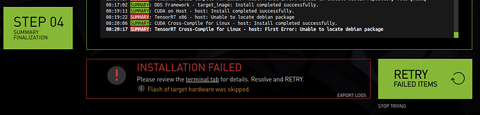

Error installing TensorRT Cross-Compile for Linux
Hi
Installing Drive AGX by SDK Manager, with Ubuntu 18.04.6 LTS.
I screenshots and log zipped in attached file, please help.
AGX_InstallFail.zip (526.5 KB)

Still the same problem, I just tried again, please see the attached screenshot:

ERRORS on:
08:34:52 SUMMARY: TensorRT x86 - host: Depends on failed component
08:36:42 SUMMARY: TensorRT Cross-Compile for Linux - host: First Error: Depends on failed component

SDK manager finished, still with same error:
08:17:11 ERROR: cuDNN Cross-Compile for Linux - host: command terminated with error
08:17:11 SUMMARY: TensorRT Cross-Compile for Linux - host: Depends on failed component
