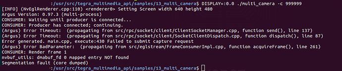

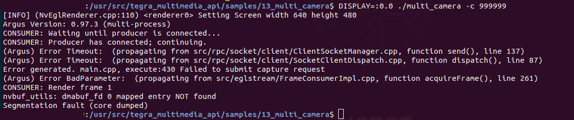

we try to get 3 cameras running with a custom carrier board (Jetpack 4.3).
We have FPD-Link III cameras (Sensor IMX390) from d3 engineering (https://www.d3engineering.com/). and want to use 13_mulicamera sample.
If we close the 13_mulicamera sample argus_daemon crashes and we have to make an reboot of our system to get the thinks running again.
Please see the attached logfile (/var/log/syslog)

If we use the same sample with USB cameras the argus_daemon have no issues
nvidia@nvidia-desktop:~$ tail -f /var/log/syslog
Jan 17 09:57:35 nvidia-desktop nvargus-daemon[5731]: === multi_camera[8957]: CameraProvider destroyed (0x7f9178deb0)=== multi_camera[8957]: Connection closed (7F958641D0)=== multi_camera[8957]: Connection cleaned up (7F958641D0)=== multi_camera[9229]: Connection established (7F958641D0)OFParserListModules: module list: /proc/device-tree/tegra-camera-platform/modules/module0
Jan 17 09:57:35 nvidia-desktop nvargus-daemon[5731]: OFParserListModules: module list: /proc/device-tree/tegra-camera-platform/modules/module1
Jan 17 09:57:35 nvidia-desktop nvargus-daemon[5731]: OFParserListModules: module list: /proc/device-tree/tegra-camera-platform/modules/module2
Jan 17 09:57:36 nvidia-desktop nvargus-daemon[5731]: OFParserListModules: module list: /proc/device-tree/tegra-camera-platform/modules/module3
Jan 17 09:57:36 nvidia-desktop nvargus-daemon[5731]: NvPclHwGetModuleList: WARNING: Could not map module to ISP config string
Jan 17 09:57:36 nvidia-desktop nvargus-daemon[5731]: NvPclHwGetModuleList: No module data found

What can we do?
