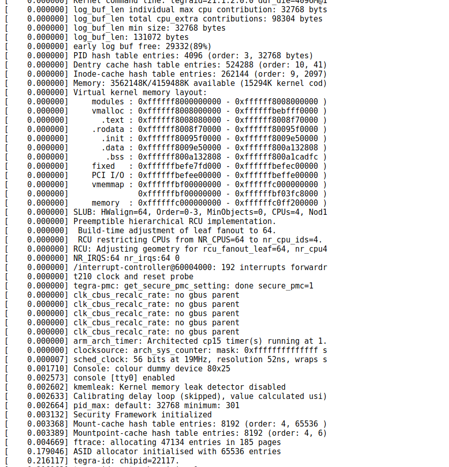

Yeah, here are the logs for that with quiet removed. This was with an older version of JetPack 4.3 from Avermedia. But it technically is the farthest I have gotten. I also swapped the dtb file from 4.6.5 and added that to this one.

Hi @jacob.faile
We are in the right direction now but you still need to fix one thing here.
Please resize your terminal when you dump log.
As you could see each line of your log got truncated, there is a perfect cut here…
Okay. Ill regenerate that right now with the resized terminal. Sorry about that.
I can see the fatal one from this partial log.
Why is the system trying to mount file system from ā€œmmcblk0plā€?
The partition name should be mmcblk0p1. Not ā€œlā€.
Ill take a look and see where that is happening at.
Okay. It might be working now.
I used the latest version of JetPack 4.3 from Avermedia. I then replaced the /kernal/dtb/tegra210-p3448-0002-p2449-b00.dtb and the /rootfs/boot/tegra210-p3448-0002-p2449-b00.dtb that was in 4.3 and replaced it with the same file in 4.6.5. I also took the /bootloader/tos.img from 4.6.5 and replaced the 4.3 one with this one. That seemed to work and I am now logged into the Jetson with I think 4.3.
