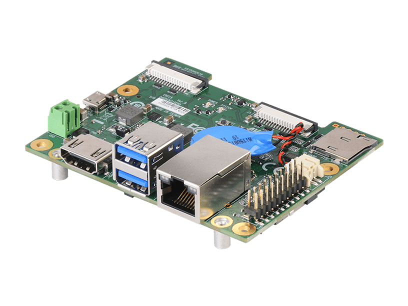

I am trying to get a Jetson Nano flashed , but am running into some issues. I am using an Avermedia EN715 carrier board and have tried multiple BSPs. The Jetson module I have is this one:

Here is a link to the EN715 carrier board and the BSP for Nano can also be found at that link.
That method’s results can be found in avermedia_flash_log.log

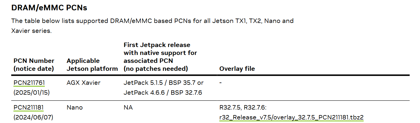

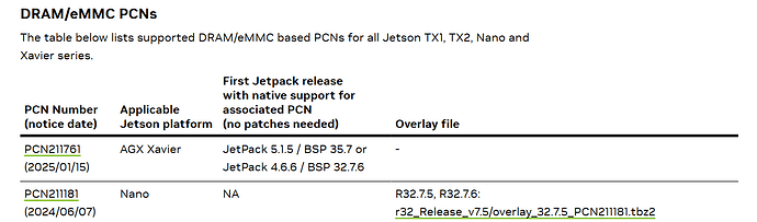

Guessing that might be related with the PCN211181, you can find more information in * Jetson PCN Summary
So do I need to apply this overlay file?
And would this work for Jetson Nano with Jetpack 4.3 (R32.3.1)? It seems to say it is for R32.7.5 or R32.7.6 and there are no other options for the Jetson Nano.
There is no overlay patch for JP4.3/R32.3.1, but you may try to apply that existing one to see if can work.
