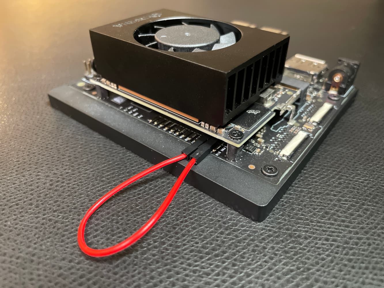

Hello @raghu.in10straining,
Sorry to hear that you are still having issues with your Jetson Nano.
If it is continuously booting in recovery mode, it might be that the pin to force the recovery mode is connected to ground.
Can you please double check that there are no jumpers connected as depicted on the following image ?
The jumper might not be a cable like in the picture, but also a small rectangle one that covers the two pins.
Please let us know if that is not the case.
regards,
Andrew
Hello Andrew,
I don’t have any jumpers connected, here’s my jetson nano developer kit image for your reference
Regards
Raghu
