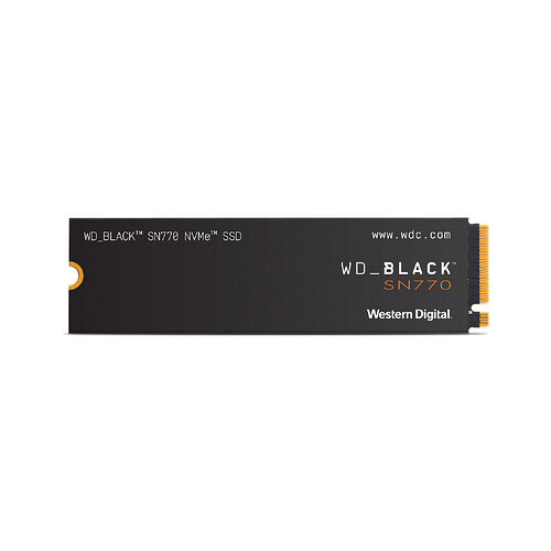

I want to extend the storage of the “Jetson AGX Orin Developer Kit”.
I need around 1-2TB of storage. It should support high load and high read/write performance.
Will this product fit into the developer kit?
If not, can you suggest specific SSD devices that work well with the developer kit?
The Sandisk 2TB WD_BLACK SN770 NVMe SSD is likely compatible with the Jetson AGX Orin Developer Kit, given that:
  • The Jetson AGX Orin Developer Kit has an M.2 M-Key slot (J1) that supports 2280 size NVMe SSDs using a PCIe x4 interface.
  • If the Sandisk SSD fits these specifications (2280 size and PCIe x4), it should work.
However, we do not test it yet, you may also do the search in forum to refer what other develoeprs used.
