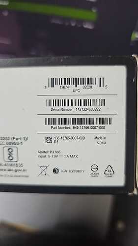

Is this a custom carrier board design, or from one of our ecosystem partners? Could you confirm which Jetson module you are using?
It is the standard issued carrier board that you guys offer with your dev kit. I’m using the Jetson Orin Nano 8GB Module.
Could you send picture of the carrier board with the part number on it?
Is this the only unit on which you have issue or you have tried other units and they are working as expected?
