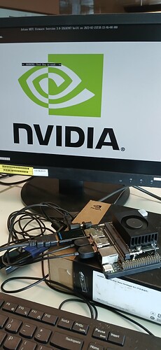

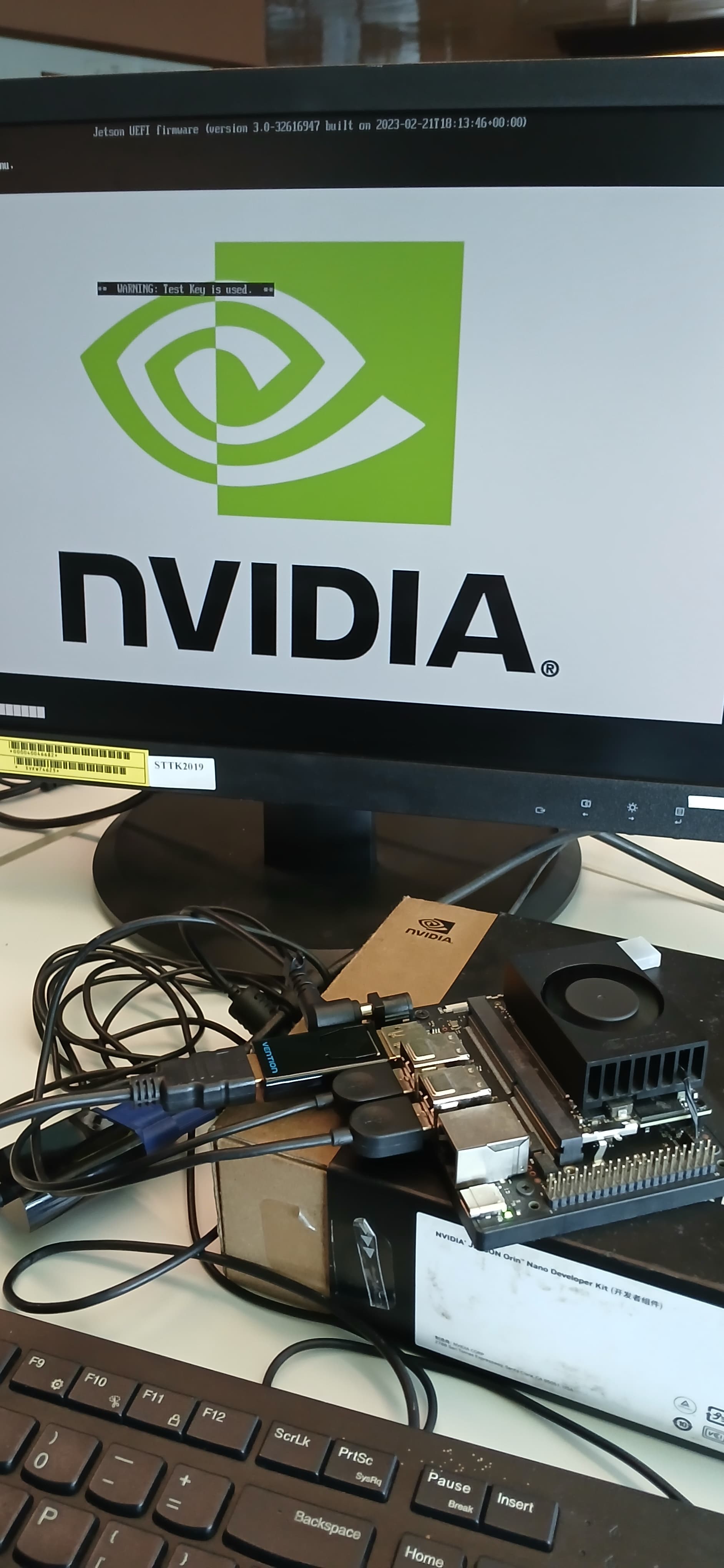

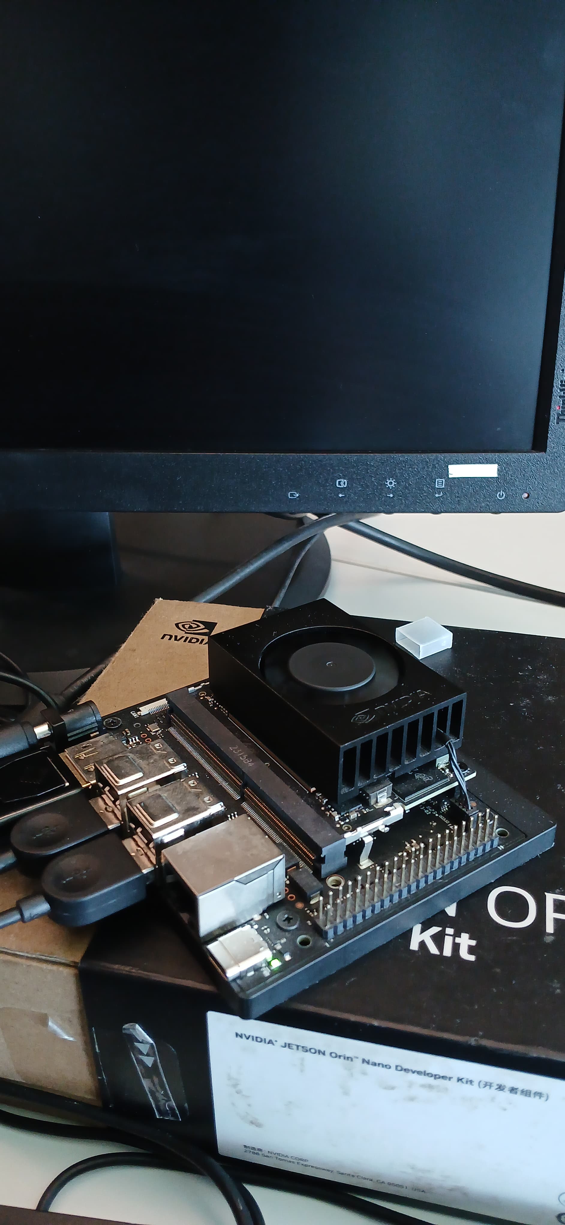

Dear,
We write image to microSD card using JetPack 5.1.1 and we have SSD Nvme. Previously, there were no errors with the console display, but after we set the datetime to ‘off’ (disabled automatic synchronization using the internet), this error occurred. Below is the image documentation that can be displayed. We kindly ask for a solution to this issue. Thank you.
Booting Process is successfully
Cannot console display, but LED and fan indicator ON

Are you talking about the Ubuntu GUI? Or you are talking about the console on the screen?
Thank you for the explanation. Sorry, We are talking about the Ubuntu GUI
please use the UART serial console and dump the /var/log/xorg.0.log, attach it here.

Your rootfs on sdcard is corrupted.
This is known issue on old rel35 release, please upgrade the BSP version and it shall get resolved.
Thank you for your input. Since this is the second time I’ve encountered this issue, could you recommend which BSP version is stable and reliable for my setup? I would like to ensure that I avoid this error moving forward
always use the latest one. For rel-35, it is rel-35.6 now.
