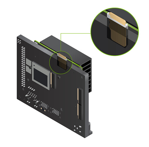

Did you try using SD card to test it?
Message in your photo looks like you haven’t install any storage to Jetson Nano Dev Kit.
Jetson Nano Dev Kit does not come with any storage.
I am not sure if I understand your question. Im not an expert regarding Jetson.
You can refer to these 2 getting start information to prepare SD card and try to boot the Jetson.
If you would like to use M.2 SSD, you have to use SDK Manager to flash it with Ubuntu host (Physical Host, Not VM). VM is not easy to make it works to flash the M.2 SSD.
i cannot remove the sd card without dismouting the board. It came in this bundle by holybro.
