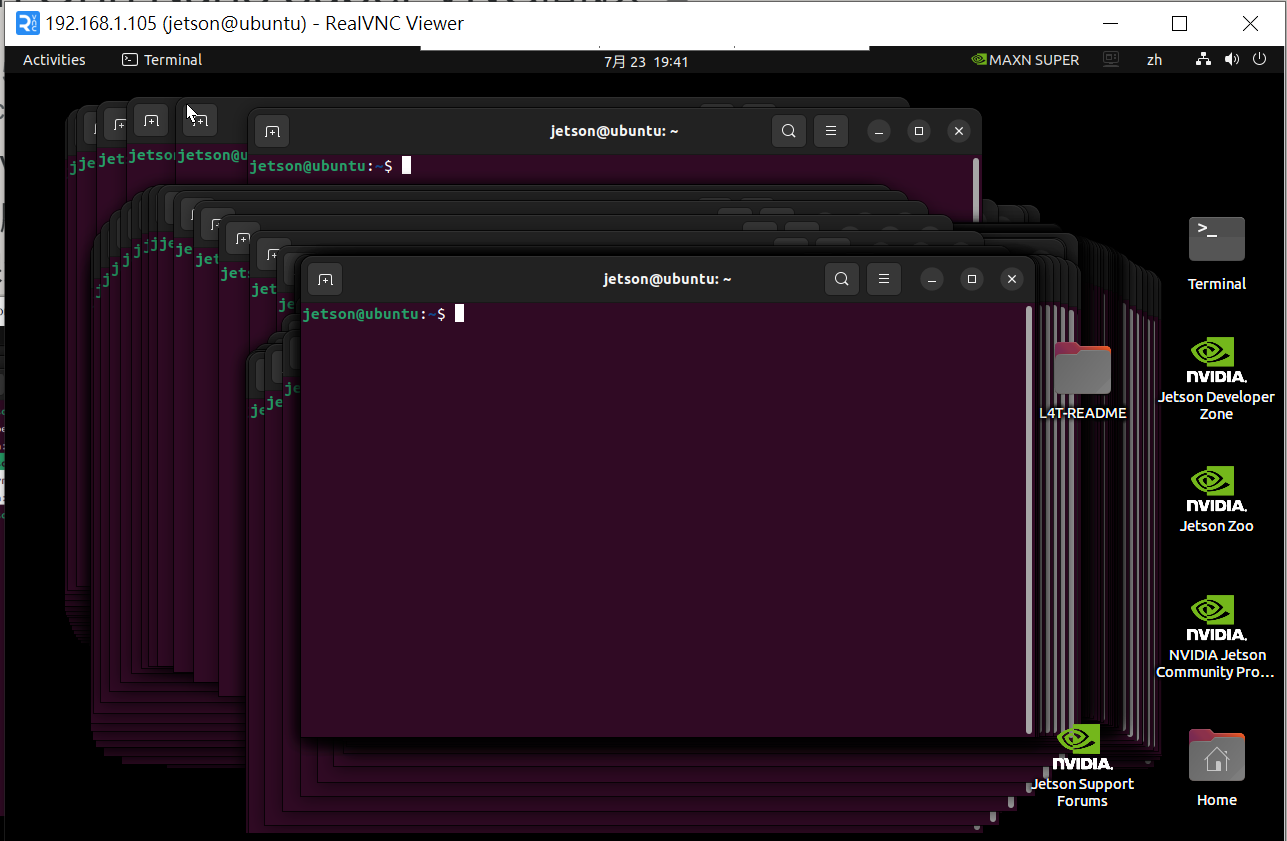

I’m getting screen ghosting and the taskbar doesn’t show up when I use RealVNC on Windows 10.
I switched to a Windows 11 computer, but it’s the same.
I tried both USB-C and Ethernet connections, and even switched to TightVNC, but the results are still the same.

Is your Orin Nano connected to a monitor, or are you running it in headless mode?
My Orin Nano is not connected to a monitor. I’m using VNC to access the desktop remotely.
So it’s running without a display, but not in headless mode.
The issue has been resolved.
It was caused by compatibility and rendering problems.
I switched to xfce4, stopped xserver, and used NoMachine instead — now it works fine.
