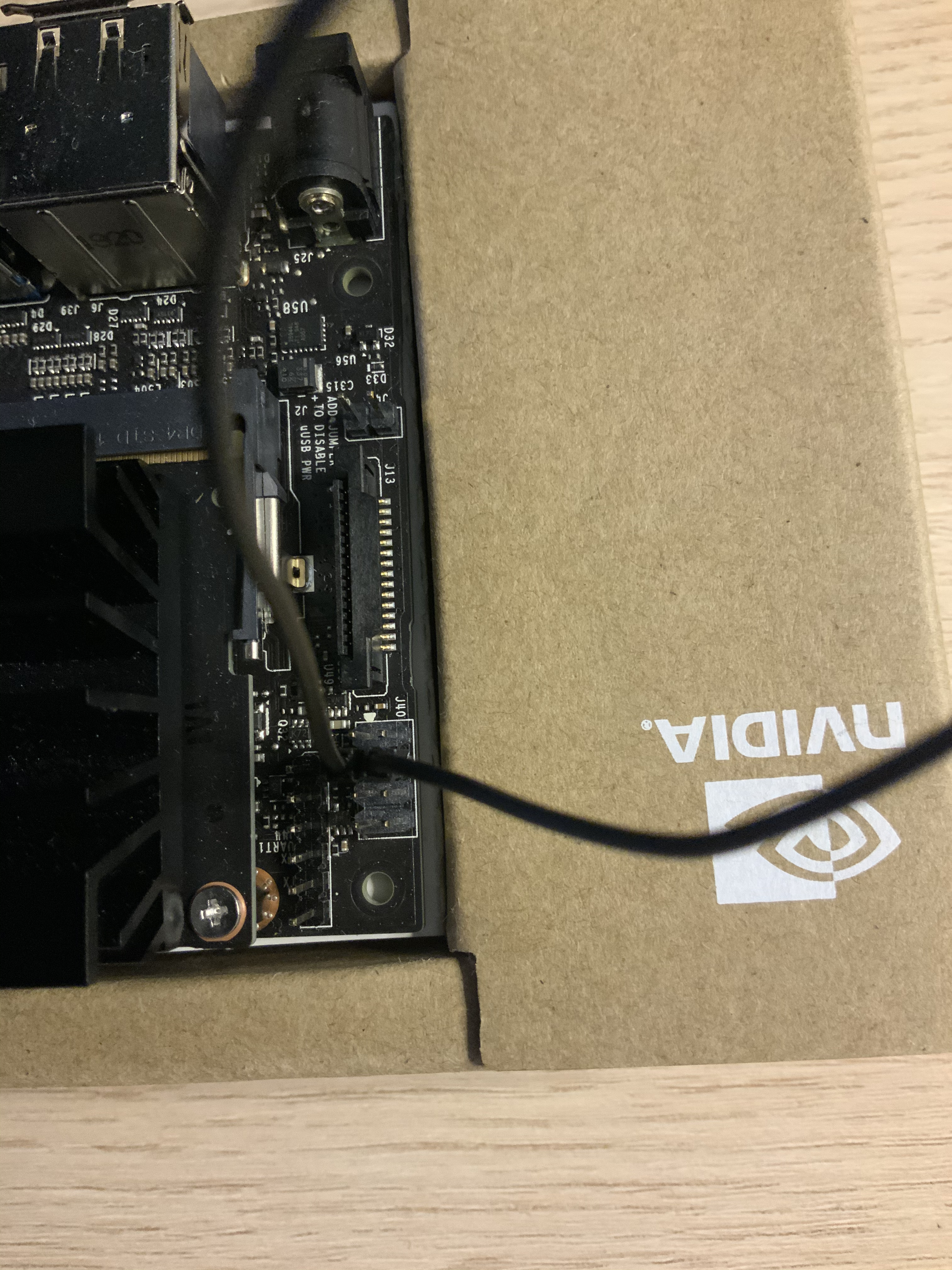

Could you take a picture of your board and how you connect your board now?

Just to clarify, I’m using a micro-sd card.
Here is my setup:
It looks no problem. Not sure why it failed to start the flash process.
Your board was able to start the flash process yesterday. Did you remember what was the hardware setup at then?
