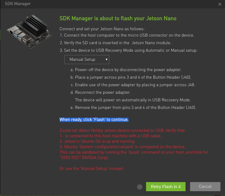

I’m using Ubuntu host machine. Am I able to reflash it with the existing card? Do you have a guide on this method? How do I run recovery mode?
I’ve got sdkmanager installed but I’m not sure how to talk to the device
Hi tarin.eccleston,
Please reference instructions to install with sdkmanager guide.
And reference Nano User Guide to put device into recovery mode.
I am absolutely lost. The second link you showed me is broken.

I cannot connect to my device and I’m unsure which pin is where for the recovery mode.
You can also check “Jetson Developer Kit User Guide” from Download Center.
This is what I get if I try to run in recovery mode. I’m using USB to micro-usb connection only from host to device only.
Hi tarin.eccleston,
You need put device into recovery mode by manually.
Below information is from Nano user guide:
[J40] Pins 3 and 4 put the developer kit into Force Recovery Mode if they are
connected when it is powered on.

Okay, so here’s the current status. I have sdkmanager opened with the “flashing Jetson OS” at 99.9%. The device is plugged in from USB to micro-usb from the computer. The jumper pins are connected between 3-4 on J40.
I have the flash.sh file in the Linux_for_Tegra but even after entering that command it still says that it can’t find the command.

From terminal:
/Linux_for_Tegra$ sudo ./flash jetson-nano-qspi-sd mmcblk0p1
[sudo] password for tarin:
sudo: ./flash: command not found
tarin@tarin-Z370-HD3:~/Downloads/Jetpack/nvidia_sdk/JetPack_4.3_Linux_P3448-0020/Linux_for_Tegra$
Hi tarin.eccleston,
Sorry for typo.
Please run below command again:
$ sudo ./flash.sh jetson-nano-qspi-sd mmcblk0p1
