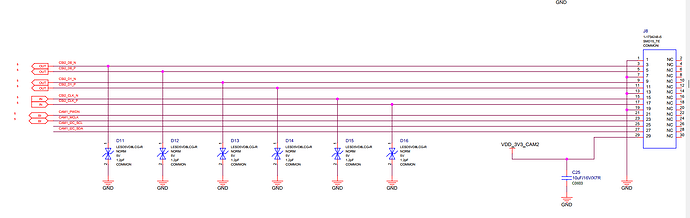

This is the sch of the custom carrier board. You can see that csi0, 1, and 2 are indeed used.
hello Baobaobaoziai,
according to schematic, you’re using CSI0, CSI2, CSI3.
so, the device tree property settings should be.. please double check the port bindings.
CSI0/ serial_a/ port-index=0.
CSI2/ serial_c/ port-index=2.
CSI3/ serial_d/ port-index=3.
