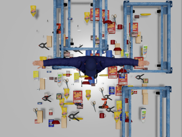

Hi, I follower offline-dataset-generation and tried to load worker model (omniverse://localhost/NVIDIA/Assets/Characters/Reallusion/Worker/Props/Worker.StandingDiscussion_LookingDown_M.usd).

to load worker. It worked but worker didn’t act. It’s static like this
0
How can I make the worker to act?
Hi, I fix some bug:
change "Xform" to "SkelRoot" in _asset = create_prim(...
However, I need to set timeline and press play from UI like this post:
Can I do these two steps from python API?
Hi, I found the solution by myself:
        timeline = omni.timeline.get_timeline_interface()
        timeline.set_start_time(0)
        timeline.set_end_time(5)
        timeline.set_looping(True)
        timeline.play()
