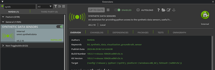

@karol.osinski the Iray AOV via Canvas is a good option as @DavidDPD mentioned in another post. i believe the only thing you are looking to use from the indoor kit is an extension called Synthetic Data Sensors so you don’t really need the entire third party extension.
once you’ve installed and activated it in Composer, you should be able to see the RenderVar option available to you.
p.s. this is used in Issac Sim to help with visualization in synthetic data generation process
