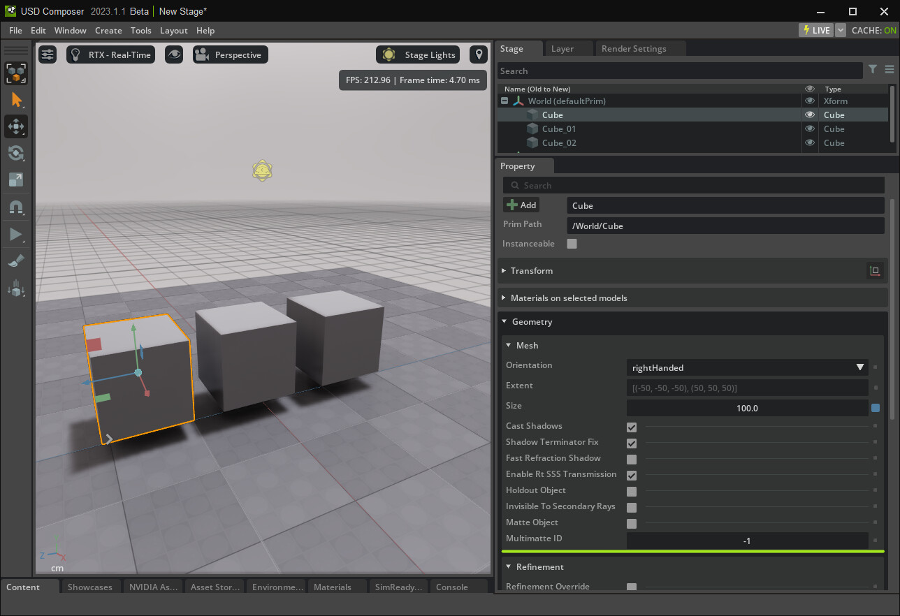

@DavidDPD in addition to setting up AOVs with your passes, OV does support Multimatte ID like in Vray and 3DS Max as well. There are a few things you’d need to do beforehand to set it up:
  1. specify the Multimatte ID on the prim - under prim property (Geometry > Mesh rollout), the value would be -1 by default; but, just like in Max where you can specify the ‘GBufferID’, OV simply refers it as Multimatte ID .

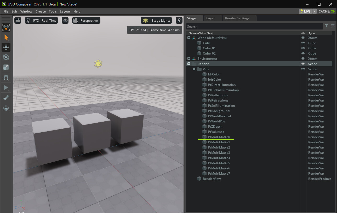

  1. establish the AOV - go to Create > AOV and add all the render passes in one go. notice the PtMultiMatte0 can be found here. this is the pass that’ll include the IDs we’ve set up in step 2.

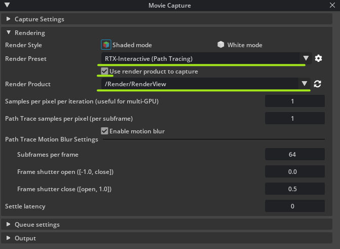

  1. configure the Movie Capture setting - shown in the recording
  1. hit render

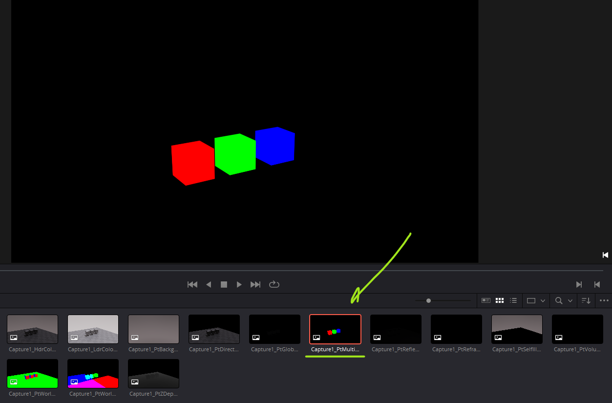

  2. check your AOVs/passes - once you are in post production software (i am using Resolve), you can verify the AOVs. even though the AOV set up in the OV stage includes several PtMultiMatte passes, only the ones you’ve included in the Path Tracing would be rendered out. my rendered example shows only one pass, and you could use it for your masks in post.

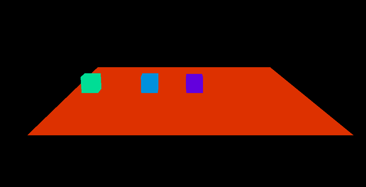

For using the automatic assign color pass, click the icon and in the drop down on RenderVar switch to InstanceIdSegmentation as shown in the screenshot below.
It will give a color pass like this as shown below where which parts is auto assign a color.
For more control you can switch the drop down to SemanticIdSegmentation where you can assign the object to be the same color based on their Multimatte ID number.
