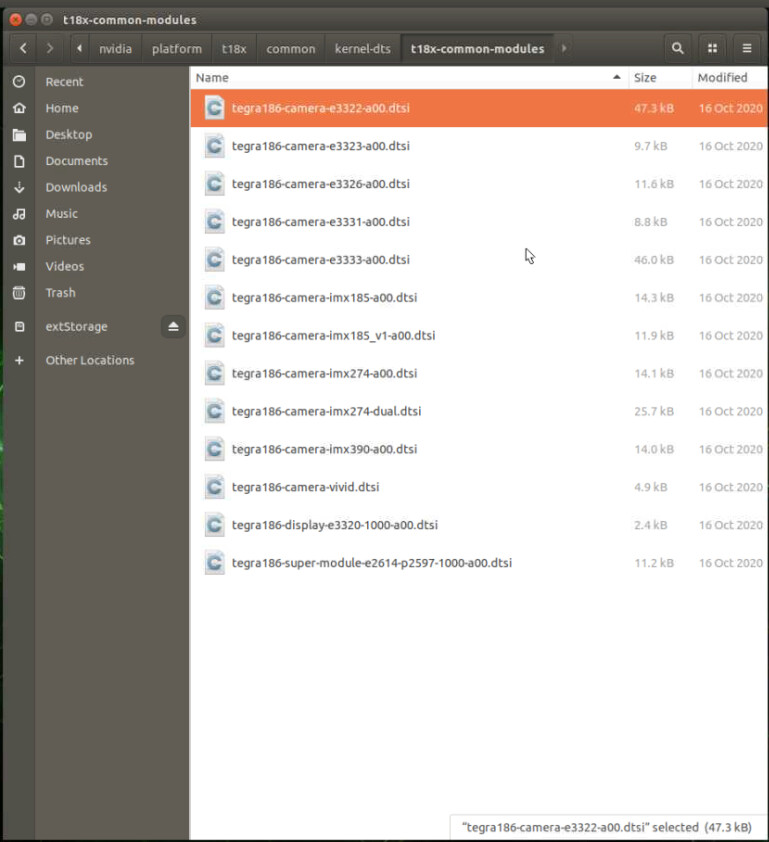

Just want to make it clear for myself since I am still learning, if I want to update this file: tegra186-camera-e3322-a00.dtsi. I should cd in the directory containing this file, and use this command: sudo ./flash.sh -r -k tegra186-camera-e3322-a00.dtsi mmcblk0p1 . Please correct me if I am wrong. Also, by .dtb, do you mean .dtsi instead?

I was not able to locate the device tree source (dts) file. I would like to modify and reuse the device tree source include (dtsi) file: tegra186-camera-e3322-a00.dtsi, which is located at …/Linux_for_Tegra/source/public/hardware/nvidia/platform/t18x. Should I compile this file instead?
I was also not able to locate the dtb directory under kernel directory or Linux_for_Tegra directory, where should I replace with the dtb file after compiling the device tree?
I also noticed that I do not have permission on modifying the Linux_for_Tegra directory, will this affect anything?
The Linux_for_Tegra was generate by sdkmanager instead of from public_source.tbz2
Will it make any difference?
Yes, the Linux_for_Tegra gen from sdkmanager used for flashing system image for specific partition, the public_source content the source code only.
Sorry, I still didn’t quite understand. If I want to compile the dts to dtb, which directory should I do it under? I still couldn’t find the dts file you mentioned before, only dtsi files, is it because I did something wrong when setting up the TX2 using JetPack or is dts referred to .dtsi file? Isn’t JetPack supposed to set up the board support package and configure the device automatically?

Thanks for the direction. I followed the document and was trying to build the kernel on the device storage, but the process terminated due to no space left on device error. I am going to build the kernel on the external storage instead, will it work if it is built on the external storage? How should I remove the kernel I just built to free up the internal space, without accidently removing other useful kernels?
I think you need a x86 PC as host to build the source and install sdkmanager.
Isn’t the skdmanager installed by JetPack during setup? I am not able to provide details since I didn’t set up the TX2 with JetPack myself but here is a info pic:
Do I need to install sdkmanager again? Will the host PC running on Ubuntu 16.04/18.04 mentioned in the document work?
