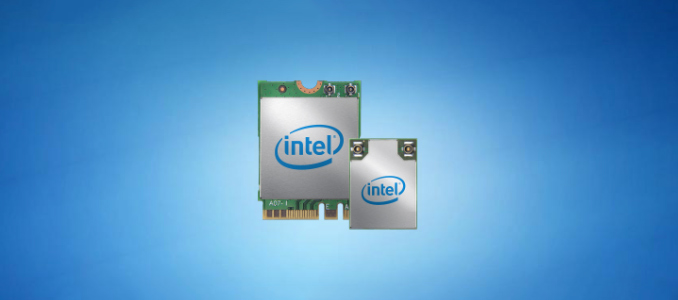

AX200 is a CNVI wifi card
which practically a little trick that bring expensive component on a wifi card to the CPU (8th gen and above) to reduce price
So AX200 definitely won’t work on ARM system. You need AX201 which is the non CNVI version
I have been using ax200 on nano and with Jetpack 4.2 on AGX previously as far as I remember
