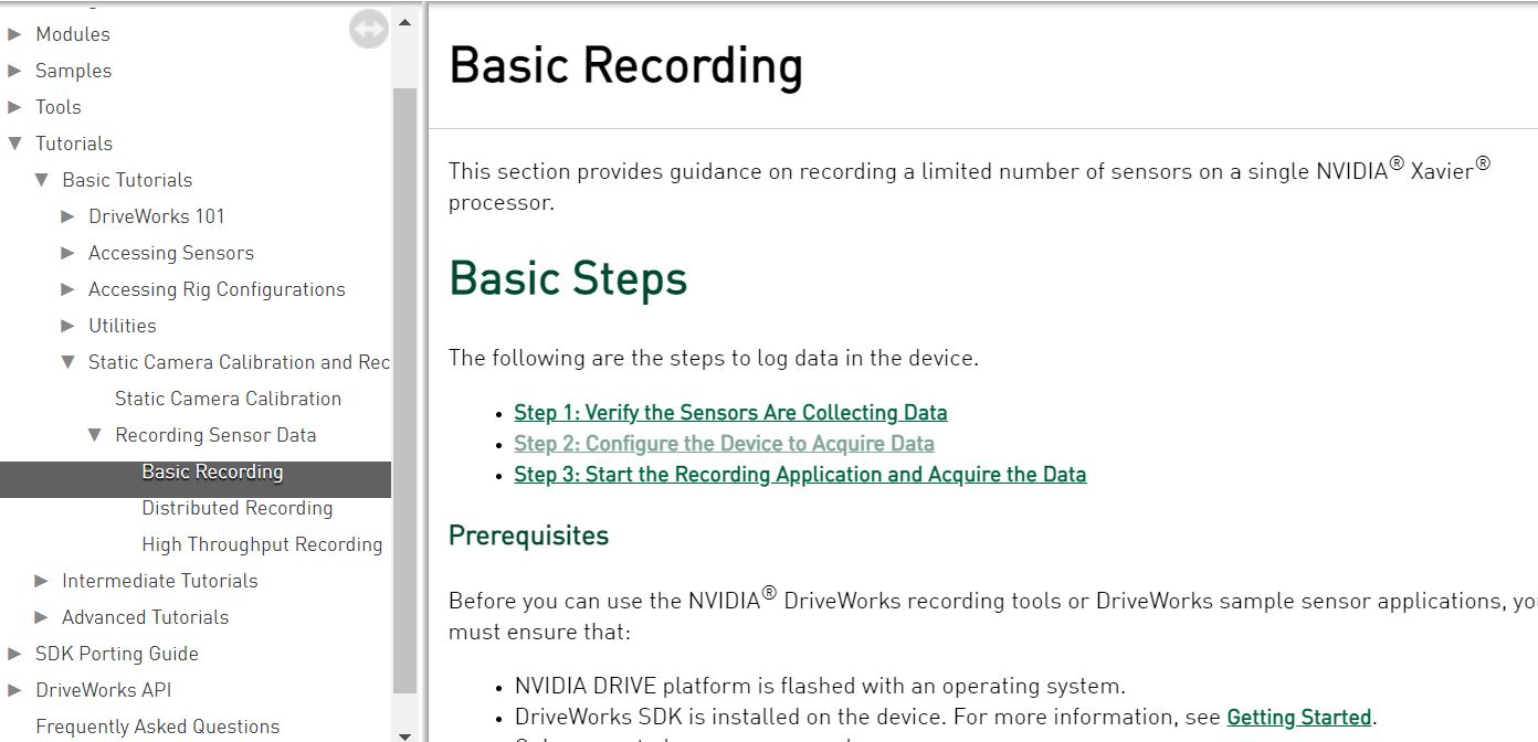

I was trying to use ./recorder-tui tool to take video records from Sekonix camera on AGX. However, the error occurs as “No valid mounts”
Error message can be found below:
root@tegra-ubuntu:/usr/local/driveworks/tools/capture# ./recorder-tui /home/nvidia/Desktop/record_config_yuv.json
Rig recordNew.json
Copying rigs and setup code…
Platform setup…
Running disk bandwidth sanity checks
ERROR: No valid mounts
recorder_config_yuv.json file can be found as:
recorder_config_yuv.json (1.4 KB)
Only one Sekonix sf3324 camera is connected to camera-port B on AGX.
Would you pls help check the reason?
Thanks a lot for your support!
Dear @weicheng.xue ,
Could you follow the instructions provided at Basic recording tutorial and verify if you see issue at any step.
The above error indicates non presence of etx4 partitions on target. Could you please share output of /proc/self/mounts

Sorry for the late reply.
First, I check the ext4 format of my USB stick.
Then, I just copy the recorder_config file from the instructions(not from hyperion) and change some parameters according from my own settings.
The config file I use now can be found here:
recorder_config_AGX_yuv.json (1.4 KB)
I will be glad if it helps.
