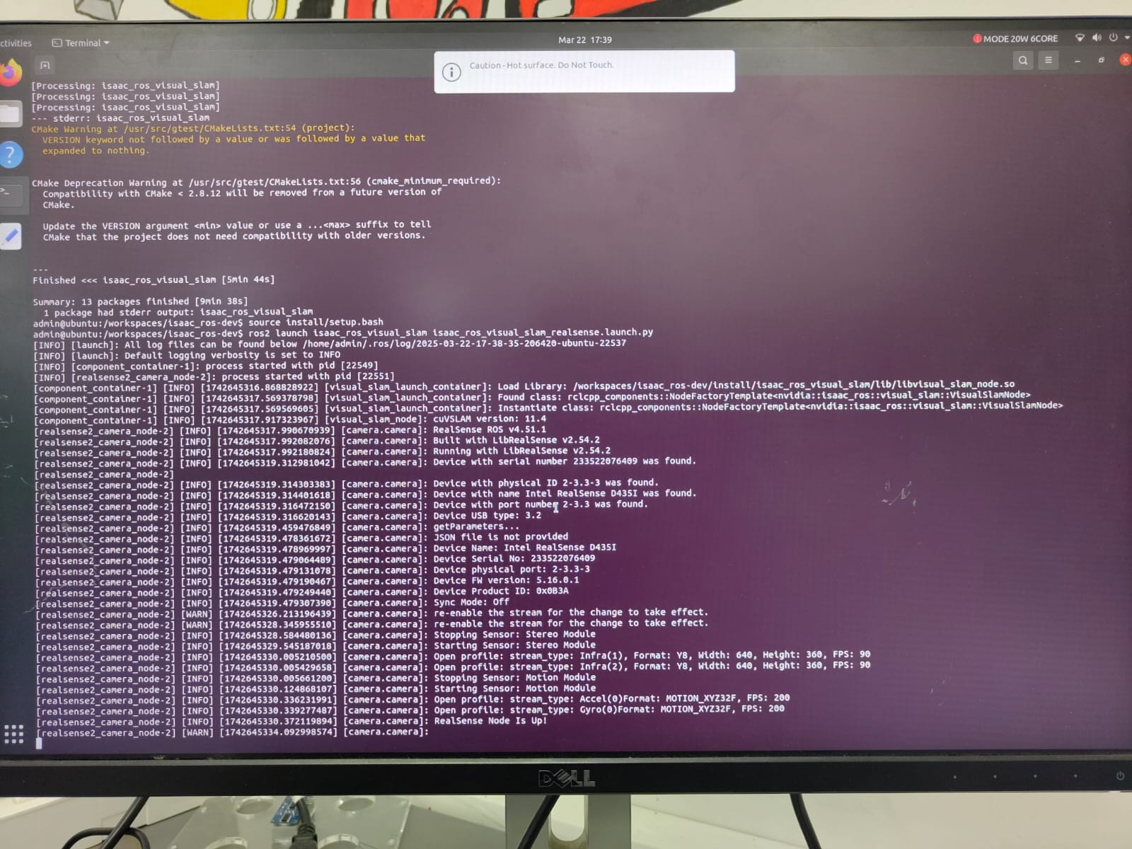

No VSLAM output when trying the issac ros (v2.1) vslam example with a realsense D435I on jetson Xavier NX
jetson xavier nx running jetpack 5.1.2,
realsense D435i, firmware is updated
usb cable is 3.2
installed Issac ROS v2.1 and the respective 2.1v release files onto the Xavier, initially we faced a issues with the container failing to build due to lib real sense mismatch , which i put as a separate post here Cant build isaac ros image to use vslam
after trying to get it work, it started working when i ignored this step on the real sense setup
after successfully launching the container, we again faced problems building the VSLAM packages with colcon build, we even reflashed the xavier and still there were problems
anyways we were able to launch the vslam example with the realsense camera, yet we are not receiving any vslam output
these are the topics that are being displayed
topiclist.txt (1.4 KB)
and when we tried to check with running ros2 topic hz /camera/infra1/image_rect_raw --window 20
and ros2 topic hz /camera/imu --window 20 there was no output from the terminal

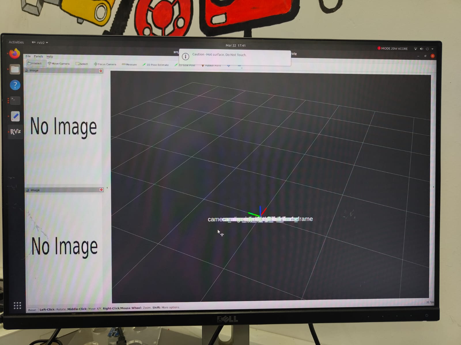

here i have provided the logs when i launched the isaac ros vslam realsense, rviz visualization launch and the topic list, along with images

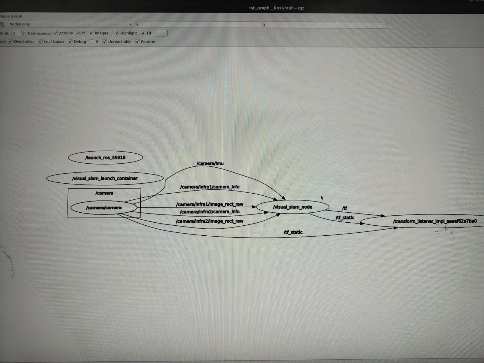

By the way, looking at your type of errors, it seems like the nodes are not communicating well with each other. Check with rqt_graph and with ros2 node info to see if everything works well.

hey Raffaello, i have moved to using issac ros on my x86 system with rtx4090, yet we still face the same issue, i have installed everything in accordance to the documentation including the required versions linrealsense, realsense camera firmware (D435i), and realsense Ros, yet we face the exact issue as we faced in Xavier
