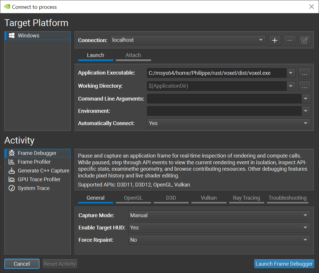

Problem is back with Nsight 2022.3 this time.
Still totally random from my point of view (worked for a while and then stopped working).
This time I kept my “broken” app : dist.zip (6.5 MB)
The Injection failed error happens with a newly created project (everything set to defaults):
Would be great if you could try to reproduce the issue on your end.
