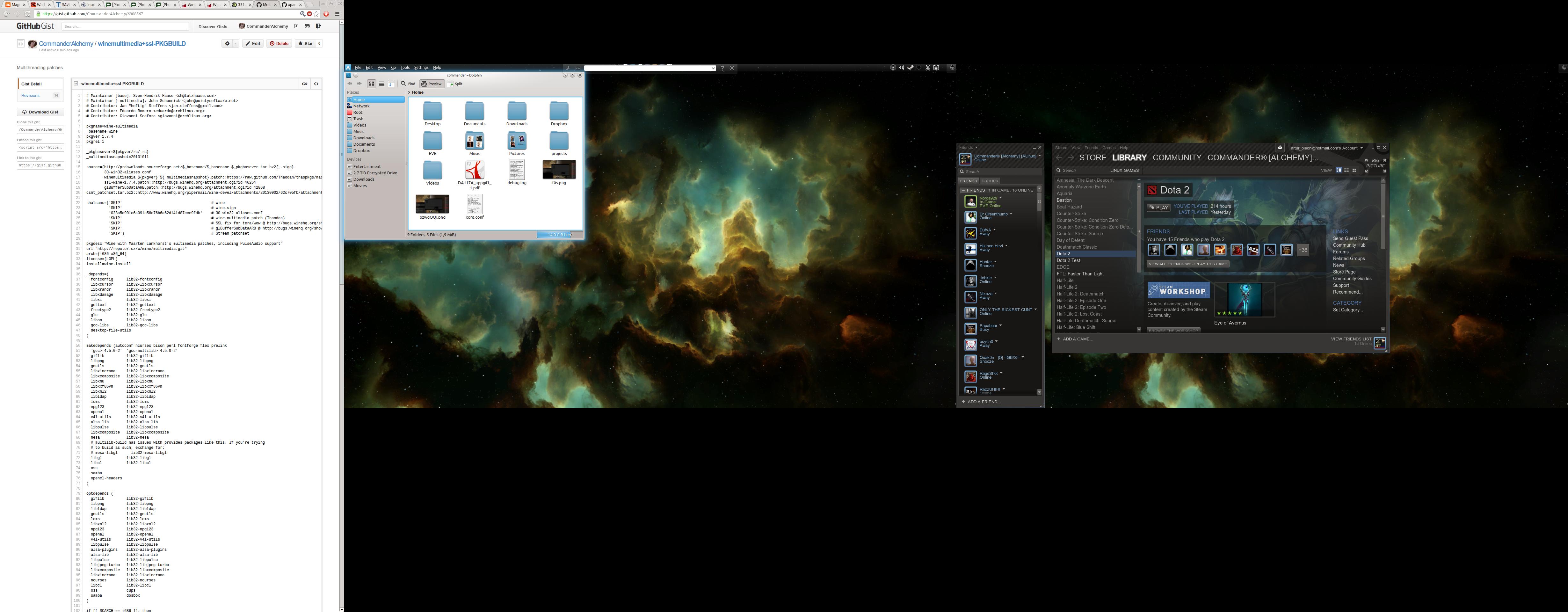

Hi there, i have noticed a weird form of regression in the latest nVidia driver (331.17)
I have 3 monitors connected to my 670GTX card. Here is a quick view over how it is set up.
Left monitor,
is in portrait mode and picture is rotated right 270c
Center monitor,
is landscape mode and picture is normal.
Right monitor,
During loginscreen and after the rotation of the image is weird. It’s like landscape though the image is in a garbled state. To fix this i have to go to display settings in (KDE) and disable rotation on that display and enable it again.
Odd thing though is that during the rotation bug all screenshots are normal.
Same for me, KDE, Openbox, TWM, XFCE, what you wish…
For me it is even worse - both screens are rotated, first left and second right. When starting X (with any WM, or just KDM), both are rotated and scaled to fit the screen (exactly as on Commander’s screenshot).
It comes back to normal state when, after starting X, I switch to some other tty, then back to graphical tty, and everything is OK.
