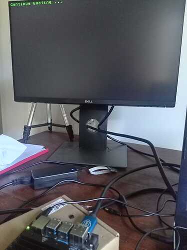

I have set up the SD card with the SD card image file as mentioned on the official website. Unfortunately, the first boot is stuck on the continue boot screen. could you please guide me with this? (I noticed that with the SD card and without SD card if the jetson connected to a display that shows that continue booting screen.
Get a x86 ubuntu 18.04 host PC and use sdkmanager to flash your board.
