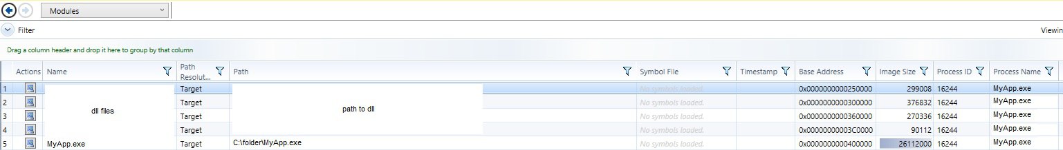

The next things I get:
Timeline stack trace:
Modules tab:
Should I adjust something in th Nsight options? (e.g. Symbol Management)

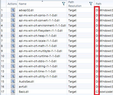

For some reason it swaps discs name in modules path.
https://pp.vk.me/c626718/v626718528/793f/DaTLHklfkLo.jpg
Windows is located on “C” and my app is located on “D”.
Seems like a bug.
I created symbolic links to solve this problem.

Do you run your sample remotely? It’s weird that some system dll are located in D:\ but not C:\
I tried on my local machine, that works fine.
An
No, I run my sample on my local machine.
I’ve tried to apply your options, but it doesn’t help. System dll are located in C:\Windows but NSIGHT thinks that they are in D:\Windows.

FYI. The bug still exists in 5.6.0.18146
My application dll’s are located in D:\ but Nsight modules paths points to C:\
