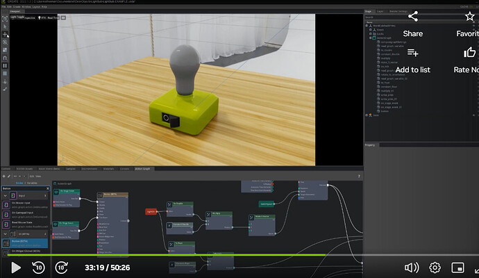

Was following this tutorial here: OmniGraph: Real-time Procedural Graph Engine for USD | NVIDIA On-Demand
In the video there’s a demo on using a Action UI button, but I can’t get it to show.
This is how I set up:
Noticed the ‘teardown’ attribute is missing.
Is this feature available? Here’s my app version:
