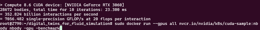

Omniverse DoMINO Automotive Aero NIM deployment Web Streaming issue
WSL2 with CUDA, NVIDIA-SMI screenshot
Main Issue:

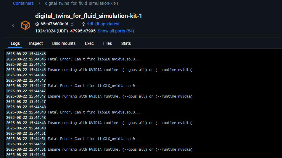

libGLX_nvidia.so.0 || GLX not found in cache, depsite "nvidia-smi " detecting the card.
Reproduction Steps:
Error Code:
This specific issue can occur on Linux systems, especially when:
  • The NVIDIA drivers are either not fully installed or incorrectly configured.
  • The libGLX_nvidia.so.0 library (essential for OpenGL via NVIDIA drivers) cannot be loaded. This may be due to missing/incorrect symbolic links, or files not present in expected directories.
  • Your system is falling back to software rendering (like Mesa/llvmpipe), which won’t work for high-performance graphics or Nvidia-specific workloads like Omniverse streaming.
Common causes and solutions:
  • You may need to ensure you used the NVIDIA driver installer correctly, and not a partial install or an outdated version.
  • Check that packages like libglx-nvidia0, nvidia-driver, and mesa-utils are properly installed.
  • You may need to set the right GLX provider using utilities such as update-glx --config nvidia or similar, depending on your Linux distro.
  • Make sure your container (if running via Docker) uses the NVIDIA runtime (--gpus all or --runtime nvidia), as libraries won’t be loaded otherwise.
  • Verify paths and symbolic links to libGLX_nvidia.so.0 and related libraries are correct (typically /usr/lib/nvidia/ or /usr/lib/x86_64-linux-gnu/nvidia/).
Bottom line:
Your GPU is detected at a hardware level, but the required NVIDIA OpenGL libraries for streaming/3D acceleration are not found by the software. Fixing your NVIDIA driver installation and GLX setup should resolve it.

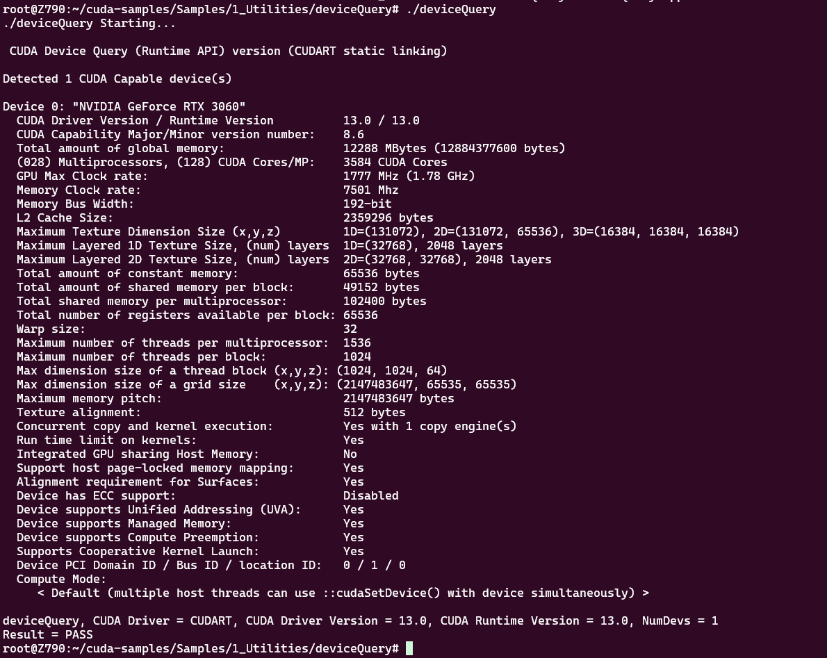

I’ve been able to get CUDA up running on Ubuntu ..
also installed mesa, libglx, nvidia drivers .. up fresh ..
vulkaninfo --summary
CTK

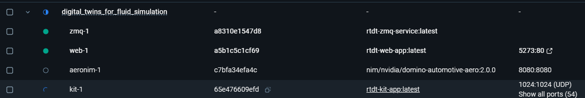

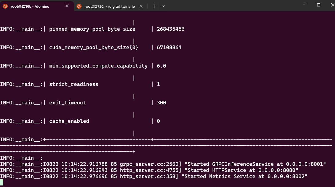

docker run --rm --runtime=nvidia --gpus 1 --shm-size 2g
-p 8000:8000
-e NGC_API_KEY
-t nvcr.io/nim/nvidia/domino-automotive-aero:2.0.0
Docker compose up -d
however Kit app still doesnt recognise the GPU compute
  1. is there something that is pushing some defaults in the Kit / app compose.yml ?
  2. can we have a unit test to try push only Kit-app using GPU ? without running the whole digital twin ..

Cuda 13 picked too ..
