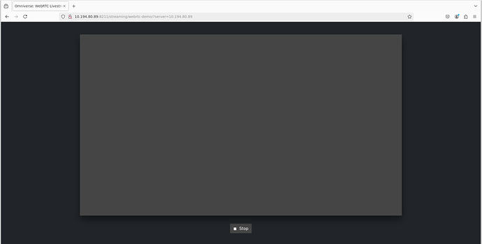

We are trying to use Isaac Sim headless Webrtc from one of the Linux workstation in our local laptop(without GPU) connected to application using Nvidia Webrtc client and also with the http link
We use the standard client applications from Nvidia. The streaming works perfectly with localhost but doesn’t work as expected when we use the ip:port of the server from client laptop
Server: 10.194.xx.xx
Client: 10.194.xx.x
Streaming IP: [http://10.194.xx.xx:8211/streaming/webrtc-demo/?server=10.194.xx.xx]
Ping works for 10.194.xx.xx
Telnet works for telnet 10.194.xx.xx 8211
