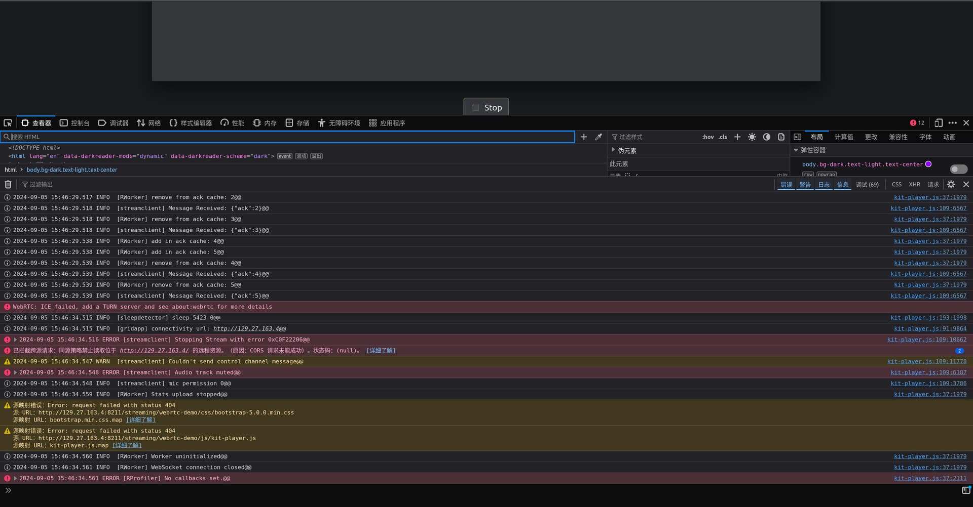

WebRCTC:
  1. Ran ./runheadless.webrtc.sh on the server
  2. Accessed http://<server IP address>:8211/streaming/webrtc-client?server=<server IP address> on local laptop
  3. Clicked the red button
Result: Nothing happened after clicking the button
in firefox
in chromium
server console output
Any help or guidance would be greatly appreciated. Thank you:)
Hey everyone, I struggled with this exact same ‘grey screen / no display’ issue on RunPod/Cloud for weeks. It turns out the native WebRTC UDP stream just cannot work through standard TCP proxies.
I finally built a solid workaround using noVNC that runs the full Isaac Sim GUI smoothly in the browser over a single HTTP port.
I posted the full explanation and the GitHub repo solution here: Running Isaac Sim in a browser on TCP-only clouds (RunPod): WebRTC livestream can't work — here's a noVNC approach that does
Hope this saves you the headache I went through last two weeks!
Hi @Sa3d-99, thanks for sharing your findings and the noVNC workaround here – that’s genuinely useful for anyone hitting this issue on TCP-only cloud providers.
We’re continuing the conversation in your new topic: Running Isaac Sim in a browser on TCP-only clouds, where we’ve also filed an internal ticket for the port-80 connectivity check issue you reported.
