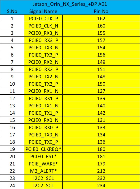

For reference - These are the PCIE connection on the custom carrier board.

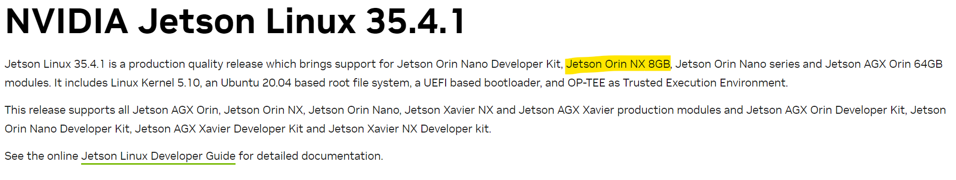

On the same note according to the documentation 35.4.1 has support for Orin NX 8GB

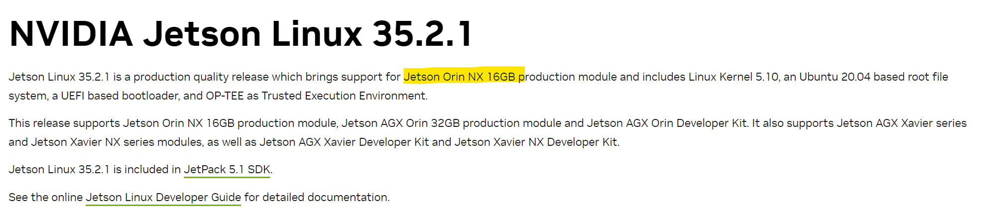

And it is specifically highlighted BSP for for Orin NX16GB is 35.2.1, this was the reason for the use of old BSP -
So to work with 35.4.1 do i need to perform some addition for the support for 16GB variant?
There is no “highlight” for this BSP. That was just because this is the first BSP start to support Orin NX 16GB…
It has nothing special and it is still a old BSP from latest one. Old BSP always has some bugs that already resolved in later version…
