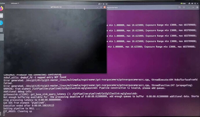

- Images could not be acquired using the imx219 camera on Orin nx.
The phenomenon is as follows:
The following multicast commands are used:
cameraTest-2.sh (762 Bytes)
Program run log:
第一次播放.txt (2.9 KB)
The system will prompt : bwmgr API not supported
v4l2-ctl --device /dev/video0 --stream-mmap --stream-to=frame.raw --stream-count=4
video0-.log (10.8 KB)
v4l2-ctl --device /dev/video1 --stream-mmap --stream-to=frame.raw --stream-count=4
video1.log (15.2 KB)
Block on the terminal after the command is executed
hello 1912680640,
may I know which JetPack release version you’re using.
we’ve test this locally and rbpcv2-imx219 it’s worked normally on Jetpack-5.1.
I followed the instructions in the manual.
Is there a way to swipe directly with sdkmanager?
The Jetson Xavier NX mirror pack and the Orin nx mirror pack seem to be the same to me.
Forgive my ignorance, but I really don’t know how to find the latest JP 5.1 release.
please download SDK Manager - NVIDIA Developer for Jetpack installation.
I have downloaded it, but there is no option for Orin nx
NV official image package is already integrated with imx219 driver? I don’t think we need to do it ourselves?
Is that right?
hello 1912680640,
sorry, am not notice that you’re using Orin NX.
you may still working with the Jetpack-5.1 release version, and please execute script file, l4t_initrd_flash.sh for flashing Orin NX.
please see-also $OUT/Linux_for_Tegra/tools/kernel_flash/README_initrd_flash.txt
hello 1912680640,
yes, IMX219 camera driver (also others) is built-in with native Jetpack release image.
you may execute Jetson-IO to configure CSI.
sudo ./tools/kernel_flash/l4t_initrd_flash.sh --external-device nvme0n1p1 -c tools/kernel_flash/flash_l4t_external.xml -p “-c bootloader/t186ref/cfg/flash_t234_qspi.xml” --showlogs --network usb0 jetson-orin-nx-devkit-16gb internal
Above are the commands I used,I got it from the Release Notes Version 35.2 EA documentation and I think it should be reliable。
I uploaded the latest log in initrdlog. Does it look normal? The system will be up after flash is successful.
flash_1-10_0_20230308-165852.log (86.5 KB)
I also want to make sure if this version image can be used normally?
yes, JetPack 5.1 is a production quality release and brings support for Jetson Orin NX.
Okay, I see. I’ll try to find other reasons.
