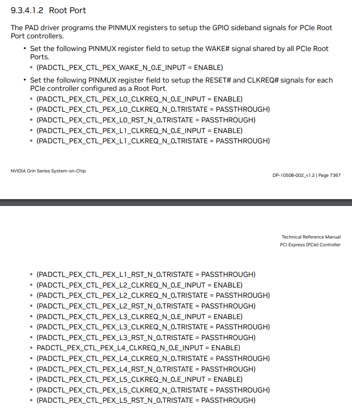

  2. Dump PADCTL_PEX_CTL_PEX_L*_CLKREQ_N_0 and PADCTL_PEX_CTL_PEX_L*_RST_N_0 pinmux values and check if settings are correct.
    • PADCTL_PEX_CTL in TRM is referred to as PADCTL_A7, which is at 0x02437000.
      • PADCTL_PEX_CTL_PEX_L0_CLKREQ_N_0 = 0x02437020
      • PADCTL_PEX_CTL_PEX_L0_RST_N_0 = 0x02437028
      • PADCTL_PEX_CTL_PEX_L1_CLKREQ_N_0 = 0x02437010
      • PADCTL_PEX_CTL_PEX_L1_RST_N_0 = 0x02437018
      bash-5.1# busybox devmem 0x02437020
      0x00000415
      bash-5.1# busybox devmem 0x02437028
      0x00000415
      bash-5.1# busybox devmem 0x02437010
      0x00000470
      bash-5.1# busybox devmem 0x02437018
      0x00000420

This pinmux results seems to be weird that 0x470 means tristatae bit is not set to passthrough.
I also dumped the result from my NV devkit and the value is different from yours. NV devkit showed 0x460.
sudo busybox devmem 0x02437010
0x00000460
Ok, let’s clarify the registers in use as I’m not sure if dumping PADCTL_PEX_CTL_PEX_L1_CLKREQ_N_0 was needed:
A: Does the PADCTL_PEX_CTL_PEX_L0_CLKREQ_N_0 correspond to lane 0 (of controller C1) and thus the PCIe lane using PCIE1_RX0? And PADCTL_PEX_CTL_PEX_L1_CLKREQ_N_0 corresponds to lane 1 (unrelated, used by USB)?
B: Or does PADCTL_PEX_CTL_PEX_L0_CLKREQ_N_0 relate to controller C0, and PADCTL_PEX_CTL_PEX_L1_CLKREQ_N_0 relate to controller C1? I can’t clearly figure it out from the TRM, can you help?

As for the pinmux, I did a double check with internal team. CLKREQ is only for L1SS and does not affect link detection. You could just ignore that.
And for your question, PADCTL_PEX_CTL_PEX_L1_CLKREQ_N is for C1. Not PADCTL_PEX_CTL_PEX_L0_CLKREQ_N_0.
Thank you for clarification. So for controller C1 we still care for PADCTL_PEX_CTL_PEX_L1_RST_N_0 (addr 0x02437018, value 0x00000420). I understand it as: PE1, no pull-up, passthrough, E_IO_HV enabled, GPIO_SF_SEL: SFIO, rest disabled. Does it look correct?
