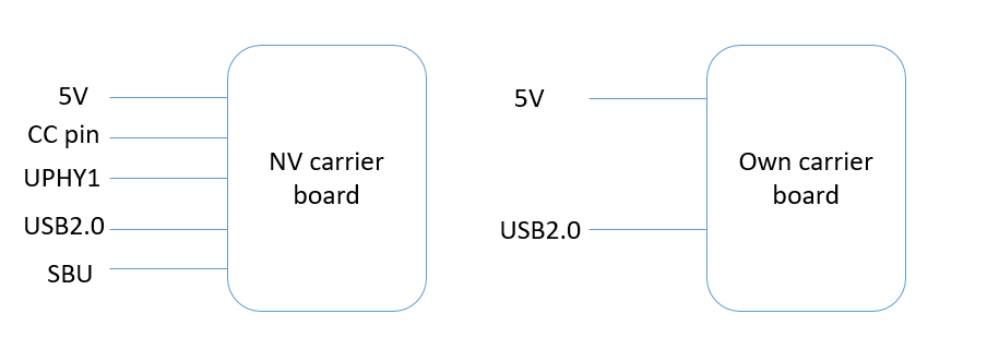

So we are designing our own carrier board for Jetson AGX orin
but the otg port(flashing port) using and debug console didn’t work
Here are the hareware difference between our carrier board and NVIDA carrier board
we are using only usb2.0 for this otg port, and we lack of CC pin in hardware design
Are these the reasons why it didn’t work?
And can anyone show me how does the NV otg port work as debug port?
Thanks,
Kevin

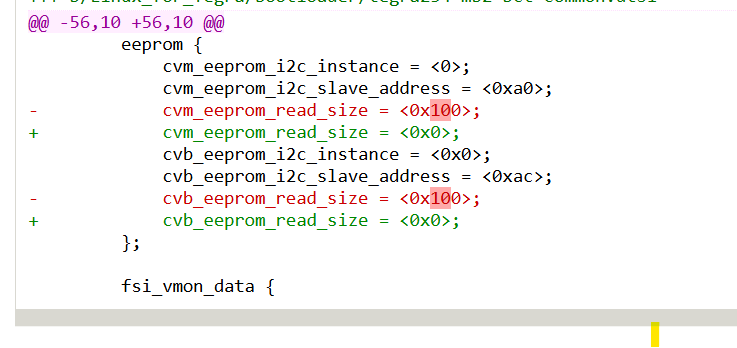

We bypass the eeprom read from booting
not sure if that caused any side effect

From hardware aspect, your connector needs to be the type that supports device mode. For example, type C/ micro USB
From software aspect, you need to modify device tree to match your hardware design… otherwise software won’t know you want to make it as device mode.

NVIDIA devkit type C port is using Cypress PD controller. If you are not using this, then you need to modify device tree to match your case.
What you posted now is just a node that mentioned “this node is otg port” but how to switch between host and device are not indicated. The driver won’t switch them automatically.

What you are asking is usb knowledge.
The role switch depends on the hardware design.
Micro USB port uses ID pin and vbus-det pin.
Type C port uses CC pin.
