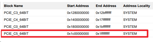

We are using AGX Xavier 32GB Module with our custom board.
And FPGA(Zync) is connected through PCIe.
PCIe Bus No.5 (pcie@141a0000) on AGX Xavier is set to16GB address as below.
Is there anyway to set 32 GB for it?
Is 16GB the limit of size ?
